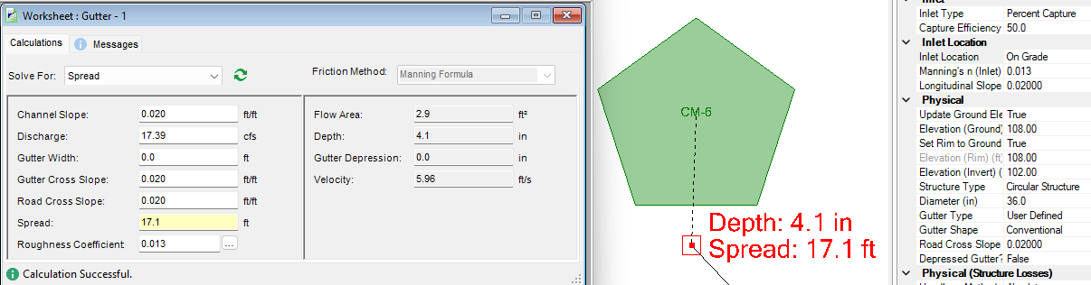

When using the GVF-Rational (StormCAD) solver, how is the depth and spread calculated for an inlet whose Inlet Type is set to "Full Capture" of "Percent Capture"?
Using the GVF-Rational (StormCAD) solver, when the "Inlet Type" of a catchbasin is set to "Percent Capture" of "Full Capture", the depth and spread are calculated by solving the Manning equation using the gutter dimensions and the surface approach flow.
The following screenshot shows the use of our FlowMaster product to verify.
