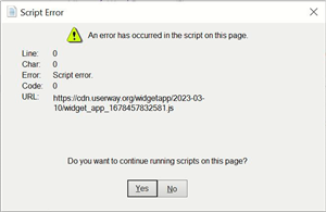

    • If you do not have internet access or need to be away from the network for a period of time, see "Reserving a license / No Internet" further below.
    • Internet Explorer 9 or greater is currently required, for the CONNECTION Client to work properly.

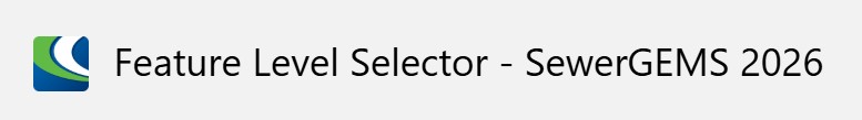

  3. Select the Feature Level
    • All OpenFlows products except for FlowMaster and CulvertMaster are licensed by feature level, for example number of pipes.
    • Your organization may own perpetual licenses and/or have feature levels available to you from a subscription (for example SELECT OpenAccess or ELS)
    • One feature level owned:
      • If your organization owns perpetual licenses for only one distinct feature level for the product you are opening, it will be selected for you automatically when the product opens. For example your organization may have a SELECT OpenAccess subscription enabling access to all possible feature levels, but you only own perpetual licenses for one particular feature level. For example three perpetual licenses of WaterGEMS 5000 pipes via OpenFlows Water Advanced.
    • Multiple feature levels:
      • If your organization owns perpetual licenses for multiple feature levels for the product you are opening, or if it only has subscription-based feature levels available (for example ELS), the Feature Level Selector will open.
      • Feature levels that your organization owns a perpetual license of are clearly differentiated from other feature levels available to you via a subscription.
      • If you select a feature level that is not owned, an alert will warn about potential term license charges, to help prevent unintended usage.
      • The number of owned licenses is clearly shown, and by default the list is filtered to show only those licenses (unless there are no owned licenses).
      • Click the "Select" button next to the feature level you would like to use (which may first check availability), then click "Done" to open the product.
      • The selected feature level will be used automatically the next time you open the software (you do not need to select it each time.) However, this means that if you have a need to temporarily select a non-owned feature level (for example to work on a model with a higher number of pipes for one project), you will need to remember to switch back to your owned feature level once done, to avoid continuing to incur term license charges in subsequent periods (quarter, for Quarterly Term License subscription, for example) if the higher feature level is not needed for those future periods. See Changing the Feature Level.
      • For details on using the Feature Level Selector, see: Setting the License Feature Level in the Feature Level Selector

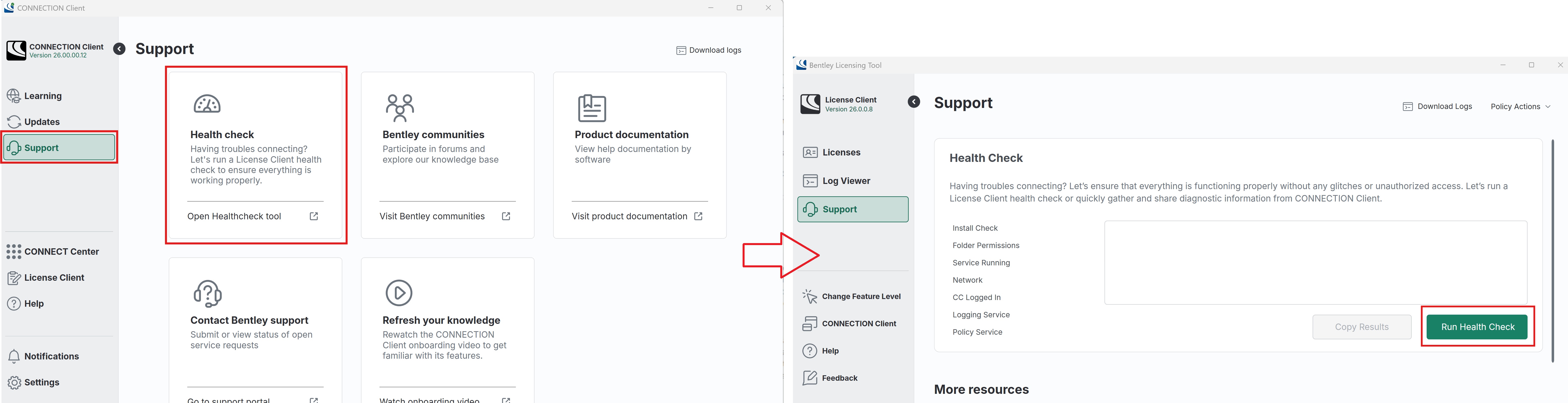

If you encounter a problem with your license, the first basic troubleshooting to perform is as follows:
  1. Sign in - Ensure that you are signed into the CONNECTION Client with your company email address.  If you receive a "Script Error" when logging in to Connection Client, please upgrade your Connection Client software to the latest version.
  2. Select feature level - Search for "Feature Level Selector - [Product Name]" in your Windows Start menu, open it. This will show all feature levels for the OpenFlows product for the organization associated with your sign-in account. Ensure that you click on the check mark next to the appropriate feature level.
  3. Confirm organization - If no feature levels show up, ensure that your account (which you signed into with the CONNECTION Client) is properly associated with your organization. If you are able to do so, open the product in question, then go to File > Help > About and check the "Site ID". This is the customer number associated with your account's organization. If you are not sure if your account is properly associated with your organization, contact your administrator (typically in your IT / Helpdesk).
  4. Get help - if the above does not help, see the detailed troubleshooting information below, then if needed, contact Bentley Licensing Support.

Unable to Sign in to the CONNECTION Client or "stopped working" error
If the CONNECTION Client is not working properly or fails to sign in, see: Sign in problems or "stopped working" error with CONNECTION Client
If you are having difficulty signing in or if you do not have an account that is linked to your organization, contact your Administrator. See: How do I find my Administrator? / Bentley user registration - Connected User setup

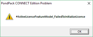

The following message appears when opening the product: "If you received an access denied message, you should close the application at this time. Otherwise, you may have reached the end of trial mode ..."
This could indicate that you have set the Feature Level to one that you do not have access to (access set to Denied on the server side). Please try re-opening the Feature Level Selector (from the Start menu), and if you see feature levels available, select the appropriate one, close the Feature Level Selector, then re-open the product. Be sure to first test the Standalone version of the product, as the AutoCAD integrated version may not be available in your feature level. Consult with your company's Site Administrator(s) for assistance with identifying the correct feature levels that you have access to. Future versions of the CONNECTION Client may filter out feature levels from the Feature Level Selector that you do not have access to (access set to denied).
If you have set the feature level to one that you have access to and are still getting this message, try the steps for item #6 for the above "Trial mode" issue.

"Failed to Initialize" error when starting the product
"This application requires the CONNECTION Client..."
"Failed to initialize the Bentley Licensing Client..."
"#ActiveLicenseFeatureModel_FailedToInitializeLicense"
If you encounter one or more of the above errors, it is an indication that the CONNECTION Client is not installed, or you have an older version of the CONNECTION Client. Please reinstall the product, or download and install the latest CONNECTION Client version from the Software Downloads site. Version 10.00.11.17 or greater is required, as of December, 2018. If you use a 64-bit computer (this is most common), be sure to install the 64-bit version of the CONNECTION Client.
If you've confirmed that the correct, latest version of the CONNECTION Client is installed and that you are signed in, please try these steps:
1. Sign-out for the CONNECTION client.
2. In the Windows Task Manager (details/processes tab), end task for both Bentley.Connect.client.exe and Bentley.Licensing.Service.exe.
3. Navigate to %localappdata%\ (enter this with the % signs in the address bar of File Explorer and press enter), open the Bentley subfolder, then locate and rename the file MySELECT.DB (for example add .old. to the end) and do the same for the file LicenseService.DB in the "Licensing" subfolder within the Bentley folder.
4. Open the CONNECTION client and sign-in. See if you see notifications.
5. Open the Bentley Licensing Tool and confirm if it shows that you have signed in.

Why does the Feature Level Selector show feature levels that I do not have access to?
As of CONNECTION Client version 10.00.13.17, the Feature Level Selector will display all license feature levels that your organization has, regardless of whether the particular user (viewing the Feature Level Selector) has access (entitlements) to them. For example if the administrator has set the General Access settings to deny access to a particular feature level, currently it will still show up in the Feature Level Selector. In a future version of the CONNECTION Client, this will be addressed so that such feature levels are filtered out. In the meantime, when clicking the "Select" button next to a feature level, you will first be prompted if you would like to check that the license is available. When choosing "Yes", if you do not have access to that feature level, you will get an "access denied" message, then have the opportunity to select a different feature level. See more above under "Product Activation" (item #4).
Feature Level Selector does not appear when opening the software
If you own a perpetual license of only one distinct feature level of the product, it will be selected for you automatically and the Feature Level Selector will not appear. If you believe that you have more feature levels owned, try opening the Feature Level Selector from the Start menu shortcut. Owned feature levels will appear in bold in the Feature Level Selector.
If you have a need to use a different feature level (for example one that is available to you as part of a SELECT OpenAccess subscription), you can select it.
"Selected" button not highlighting in blue to indicate a feature level is selected
This is a known issue in version 11.00.03.14 of the CONNECTION Client. Please upgrade to version 11.00.03.25 or greater.

Other diagnostics and License Client Logs for troubleshooting
In difficult cases, a health check can be performed, and log files can be provided to Bentley for troubleshooting licensing problems.
The Health check can be performed from the CONNECTION Client found in the Windows System Tray (lower right corner). Click the Support icon in the left side of the CONNECTION Client, choose "Health Check", this will open the Bentley Licensing Tool and click "Run Health Check". After some time, results will be available and can be provided to Bentley Support if needed.
License logs can be generated from the Bentley Licensing Tool:
  1. Open the Bentley Licensing Tool either by searching for it in your Windows search/Start menu, or by running it from within the product > File > Help > License Management.
  2. From the main menu, select Log Viewer -> "Send logs" in the up right corner; or
  3. To retrieve diagnostic data, open the Windows Start menu, enter the following command, and press Enter: %LocalAppData%\Bentley\Licensing\Logs
    1. BeLicSvc.log[.x] - contains logs for the License Service.  It is where the majority of the logging for Licensing will be found.
    2. LicenseTool.log - c​Contains logs for the Licensing Tool; or
  4. On Bentley Licensing Tool > Support > Download Logs on the up right corner.
