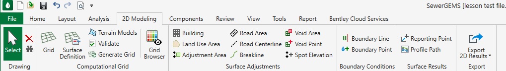

2D Modeling Menu and Options
All 2D related elements, input managers, and results viewers are located in the 2D Modeling tab in the Ribbon interface.

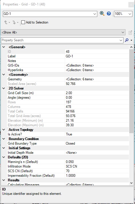

The computational grid is the area of interest for the 2D analysis. It should overlay at least part of the terrain model associated with the model. If there are 1D catchments in the model, you will want to either make sure the grid and catchments to not overlap or that the Rainfall Method is set properly in the calculation options, or there may be an overcounting of the rainfall on the grid.
The grid consists of four aspects: Elevation, SCS CN, Manning's n, and Impermeability Fraction. Each grid cell has a value for each of these. These values can be adjusted for different parts of the grid to influence how surface flows will behave. These adjustments can be made with adjustment layers using shapefiles or adjustment elements using drawing elements.
As an example, a part of a largely grassy grid may have an area of pavement, which will have different values for the four aspects of the grid. A shapefile can be applied to account for these differences. Adjustment layers or adjustment elements can also be used to adjust the elevation for a group of cells, for instance if there is a building, so that flow will go around an area instead of over it. More information on applying these can be found in sections below.

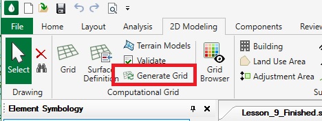

Once the grid element is added to the model, you will need to generate the grid itself. The grid is made up of smaller cells within the grid. Before generating the grid, open the properties for the grid and set the Grid Cell Size. This will define the size of each grid.
To generate the grid, select Generate Grid from the 2D Modeling tab in the Ribbon.  Note: Larger grids and smaller grid cell sizes will take longer to compute.
If changes are made to the grid, you will need to generate the grid for the updates to apply.

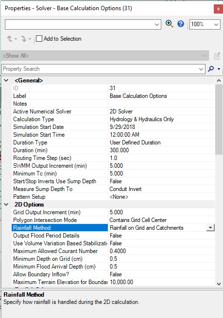

Calculation Options
The Rainfall Method set in the calculation options is key to how the rainfall will apply to the model, whether that is on just catchments or on both grid and catchments.
The option for Minimum Depth on Grid is used to used to define if a cell is considered wet or dry. If the calculated depth is less than the value entered, the 2D engine will skip the calculation for the cell. The Minimum Flood Arrival Depth value is used in the calculation of the Flood Arrival Time result.
The calculation option Allow Boundary Inflow? is used to define how inflow off of the grid is defined. If this is set to False, there will be no inflow off of the grid. If you set this to True, you can have inflow off of the grid. The option "Maximum Terrain Elevation for Boundary" is used so high elevation boundary cells are closed to inflow off the grid.

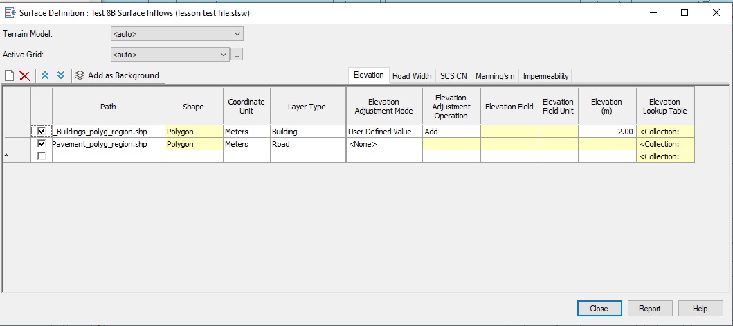

If these areas are available as shapefiles, they can be imported using the Surface Definition dialog. You will be able to add shapefiles and enter any land use information here. Once the elements are added, you can adjust values in this manager or in the properties for the element.
These surface adjustment types can also be added manually through the 2D Modeling tab in the Ribbon. Simply select the type (building, breakline, etc.) and add it to the model within the grid boundary. You will be able to adjust the land use and other properties in the Properties grid.
The shapefiles in the table are processed from the bottom row to the top. The layering will mean that if there is any overlap in the shapefile data that the shapefile at the top of the table would override data below it.
Note: Properties can also be adjusted through the element flextables. Some surface adjustment types will be available in the same flextable. For instance, "building" and "land use" are both in the Surface Polygon flextable. Surface polygons are not included in the Surface Definitions manager.

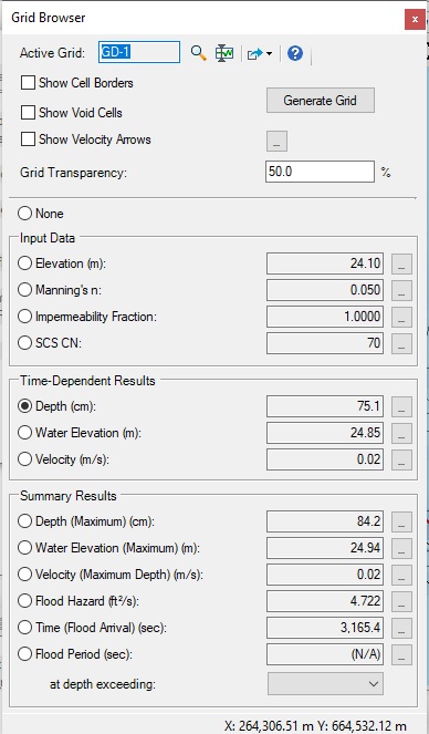

Grid Browser
Once the 2D analysis has computed, you can view the results using the Grid Browser.
With the Grid Browser open, you can view numerical input and results for the individual cells in the grid by placing the cursor over a cell. When you toggle a given input or result field, color coding will show the input or result values. For time-based results, like flow and velocity, you can use the Time Browser to see how the results change with time.

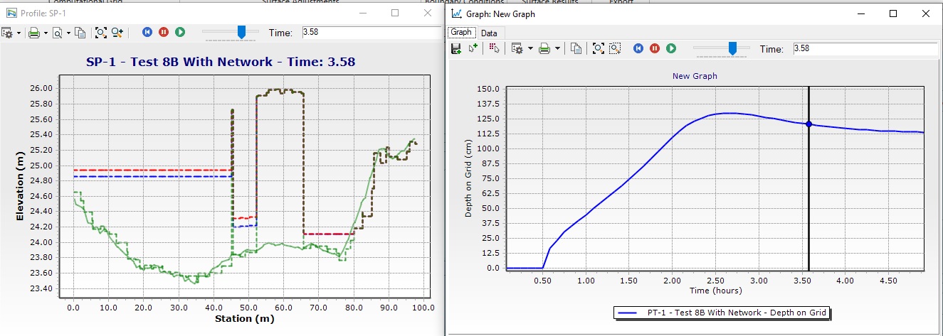

Graphs and Profiles

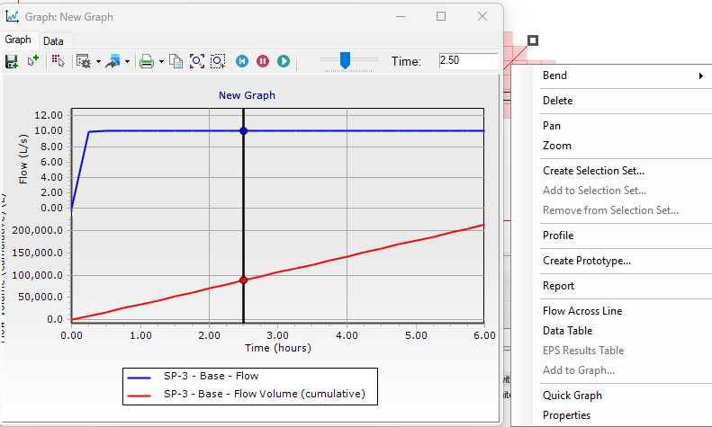

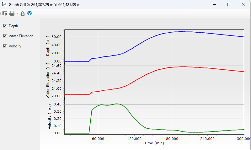

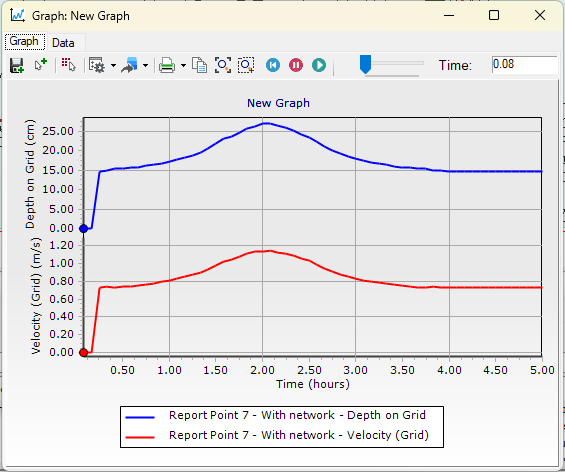

Using Reporting Points, you can generate a graph at key points in the model with 2D results, such as the depth on the grid or velocity.
Starting with OpenFlows Sewer 2026 and OpenFlows Storm 2026 (version 26.00.00.XXX), you can also graph individual cells through the Grid Browser. To use this feature, click the Graph Cell button in the Grid Browser.
This will open a new dialog where you can select Flow, Water Elevation, or Velocity. If you click on a different cell, this results in the graph will update. While you cannot save this graph, it is a quick way to view and confirm results on the 2D grid.
Using Reporting Paths to the grid. With a Reporting Point, you can. With a Reporting Path, you can generate depth results along a path of interest. To view this, right-click on the Reporting Path in the drawing and choose Profile.
Starting with OpenFlows Sewer and OpenFlows Storm version 26.00.00.XXX, you can also view the flow and volume across the Reporting Path using the Flow Across Line feature. To use this right-click on the Reporting Path and choose Flow Across Line. You will be able to view the flow and volume results across the path.

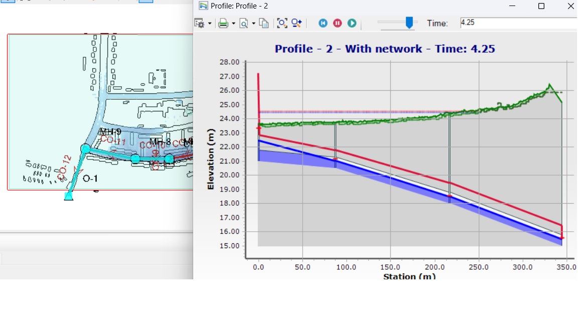

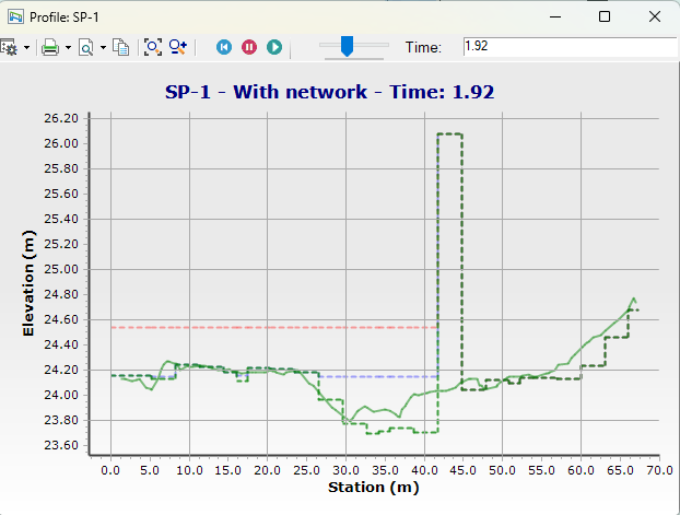

2D results are also available in the 1D profiles. When you open these after computing a 2D model, you will see the 1D results for the profile, as well as the 2D results. In the screenshot below, the 2D results are in light blue above the ground elevation.

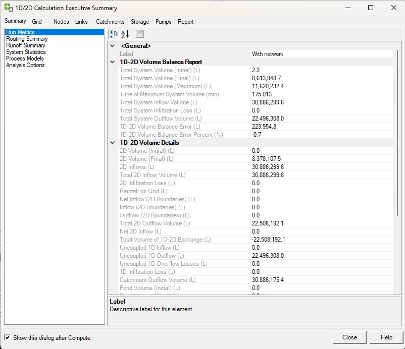

Calculation Summary
Results are also available in the Calculation Summary that is generated after computing the model. The calculation summary includes mass balance information used to assure that the model results are accurate. Included in this is volume results related to 1D/2D system. For this reason, you will be able to find volume results in the Calculation Summary. For instance, the "Total System Volume (Final)" result is the total volume of the system (both 2D and 1D). Volume results for just the 2D grid can be found in the "2D Volume (Final)." Note: These variables only account for volumes inside the 2D grid, which means it they can only be considered individually when all elements outflowing from the 1D system are contained in the 2D grid.

Cross-Sections
To view cross-section elements, you can select the desired element, right-click, and choose "Cross-section." This will generate a cross-sectional graph where you can observe if the section is overflowing.
In the 2D map, you can also see the grid cells on the margins that are flooded. You can control what to view using the time slider or the time browser control.

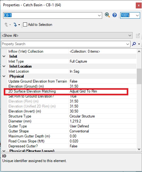

Catch Basin considerations in 2D Modeling
If a catch basin overlaps with grid cells, directed surface flow will be modeled with the 2D grid rather than gutter links. Because of this, inlet capture calculations are done with the 2D engine, though It will differ compared to 1D calculations.
In a typical 1D calculation, the bypass flow for gutter flow to an on-grade inlet is evaluated at the inlet opening. With 2D calculations, the influx corresponding to one computational grid cell at the inlet opening is used to estimate the captured flow. You may see underestimated captured flow if the grade or curb length is larger than the dimensions of the grid cell. Bypass flow is not directed flow, since any surface flow that is not captured on the grid can continue to pool at the inlet or continue downstream two dimensionally.
Note: Elevation adjustments at the inlet are important when computing inlet flow capture. Using the 2D Surface Elevation Matching field in the catch basin properties is important to assure the correct adjustments are made for simulating localized ground elevations, depressed structures, or perched structures.
Regarding surface flooding at catch basins, inlet capture is more likely governed by the available storage of the 1D network than the hydraulic capacity of the inlet opening. When the subsurface system overtops, upwelling could occur onto the 2D grid and yield non-applicable capture results. The local maximums can be important in cases like this. Noting the time of the maximum surface flow or the minimum capture efficiency (or the maximum inflow and overflow) can be more informative in identifying bottlenecks in the 1D-2D system.
