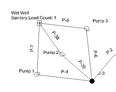

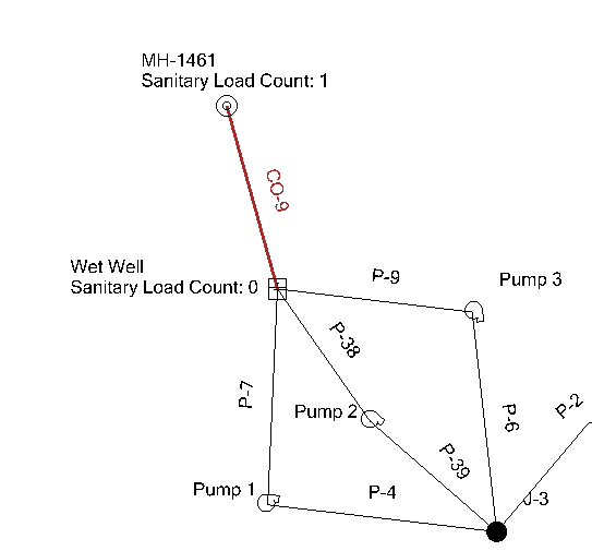

3) A wet well with a sanitary load.  Remove the sanitary load that is directly on the wet well and add it to a manhole upstream of the wet well or create a dummy manhole directly upstream and connect it to the wet well.
Before:
After:
