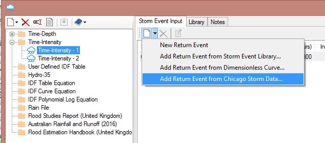

Starting with the CONNECT Edition Update 2 releases of SewerGEMS and CivilStorm, you can now add storm events based on the Chicago Storm method. For users in regions where this method is popular, this enables you to compute and route rainfall runoff using this standard method, without having to calculate it externally and bring in as a user defined hydrograph.
The Chicago Storm method is used to calculate design rainfalls of urban storm water infrastructures. This is now available from the Time-Intensity storm type:

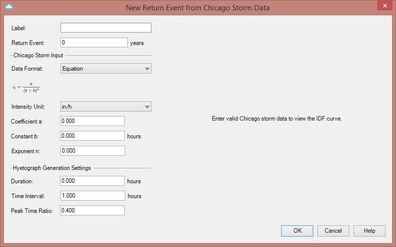

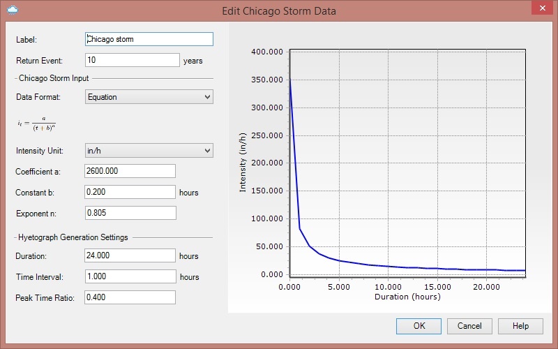

You have two methods that you can use to build the model. First, you can use the equation method, which uses this equation to create an IDF curve:
where I is the intensity, t is the duration, and a, b, and n are coefficients. Details on the equation can be found in the Help documentation.
Once you enter some coefficients, you will see a graph of intensity and time.

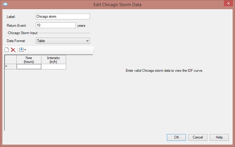

The second method is a table format. If you select this, you will have the ability to enter data manually in the table. You can also click the import button to import an existing file or existing IDF storm into the table. Data in the table needs to use equal time increments, including if you import the data. You will see a message indicating an issue if the data is incorrect.

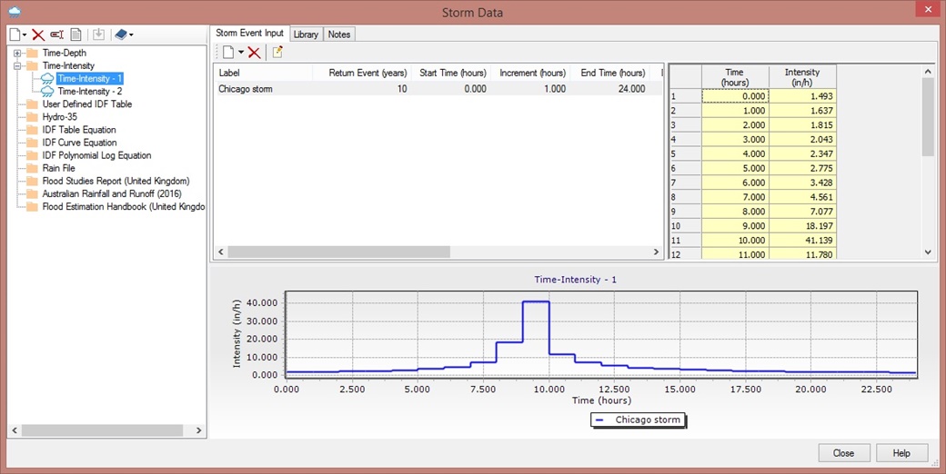

Once the data is inputted and you click OK, a storm will be created and will be available for selection in the Global Storm Events dialog.
