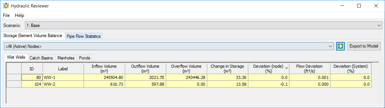

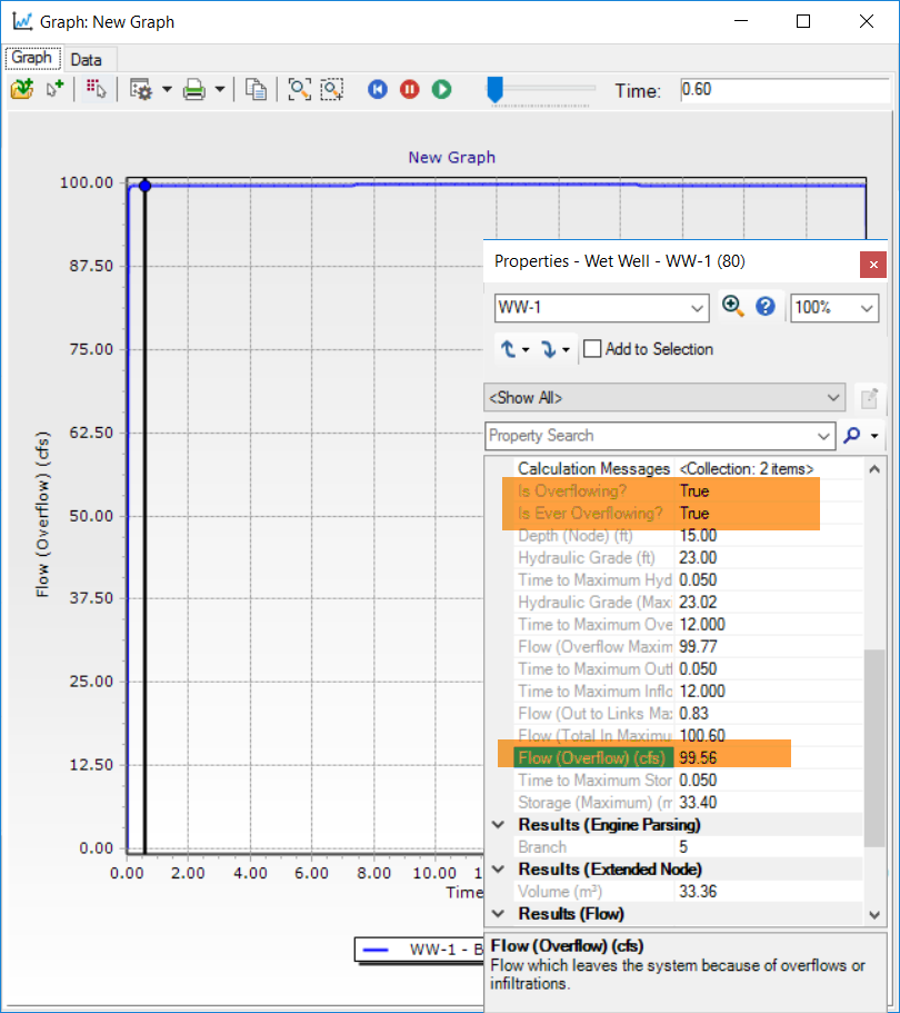

The wet well overflow volume can be graphed and seen in the hydraulic reviewer with Implicit engine.
You can quantify overflow volume under Analysis > Analysis Tools > More > Hydraulic Reviewer (Or in V8i, Analysis > Hydraulic Reviewer)
Overflow could include flow at the surface area above the wet well, as it can influence the overflow rate and potentially pond up and recede.
