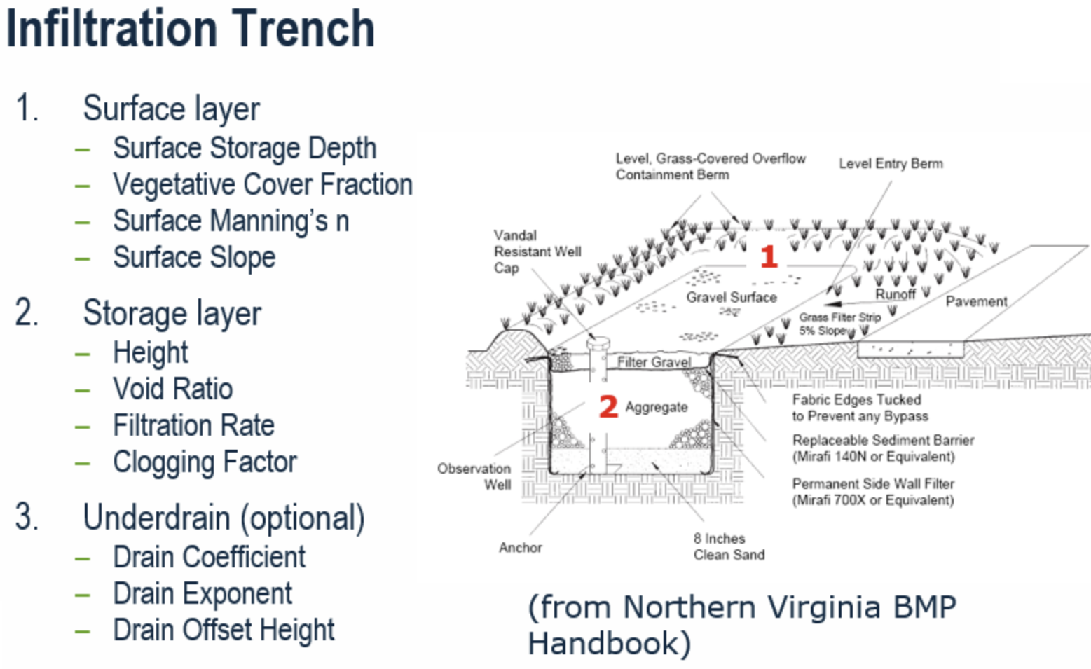

One approach is to use the "infiltration trench" LID type. Lay out the LID element and parent catchment to represent the area of the trench, then select the catchment as the LID's parent catchment. For details on LIB/catchment connectivity, see: Modeling Low Impact Development (LID) Controls
With this, you can model the storage effect of your aggregate, connect upstream pipes that discharge to it, account for underdrain outflow, and account for overflow.
Model schematic:
In the LID Control properties
- Surface layer - define the properties of the surface area above the trench.
- Storage layer - define the properties of the trench fill (crushed stone aggregate, usually) and the ground infiltration rate.
- Underdrain layer - define the properties of the underdrain, which could be used to model a pipe in the trench which discharges some captured runoff to another location.

- Catchment area: If the parent catchment represents a larger area that drains to the trench (and you don't have any pipes discharging into the trench), set the LID property "Occupies Full Catchment" to "False", then enter the area of the LID.
- Parent catchment outflow element - this can be directed to the same element as the underdrain outflow element, or a separate outflow node for example. Your infiltration trench will not have any outflow (unless using the underdrain), but in order for the model run there needs an outfall and a downstream element from the catchment.
- If pipes discharge into the trench - Use a headwall to model any pipes that discharge into the trench. In the headwall properties, set it to Free Outfall and choose the LID's parent catchment as the "Route to catchment". Ensure the LID is set to "occupy full catchment". The headwall discharge will then enter the LID along with any catchment rainfall runoff from the storm event. If you had been using a catchment larger than the size of the trench, use a new parent catchment with the same size as the LID (with "occupies full catchment" set to True), and then model another catchment for the area around it, with outflow element set to the LID's parent catchment.
- An alternative would be to run the model, copy the headwall/outfall hydrograph (Data tab of graph) and paste as an additional hydrograph inflow in the parent catchment properties. You would need to update it if the upstream pipe outflow changes.
- If trench overflow needs to be modeled - consider using the pond approach instead, using a composite outlet structure (such as a weir) to direct overflow to another location.
- To model a perforated pipe in the trench - consider using the LID underdrain option to model this (layer 4). In the LID element properties, choose an "underdrain outflow element" to direct the underdrain discharge to another location. For example use a transition element connected to a conduit.
