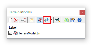

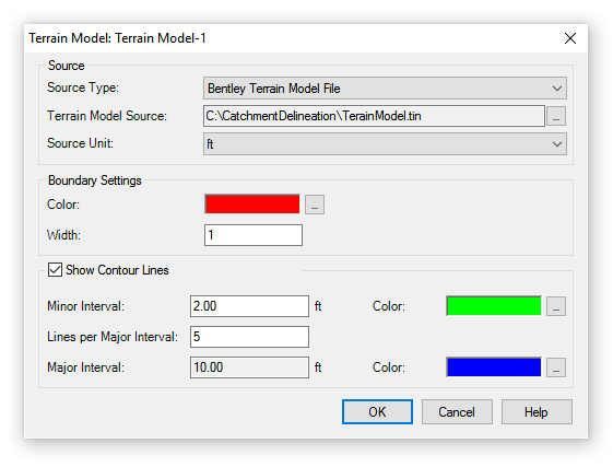

To use the Terrain Model tool, go to View > Terrain Models.  The following dialogue box will pop up.
Click on the new button to import a terrain model.  The dialogue box below will appear to select the terrain model source.  Note that there is a boundary line color, also, as a boundary is drawn around the terrain model area.
You can have several terrain models in a project, but only one can be active at a time.

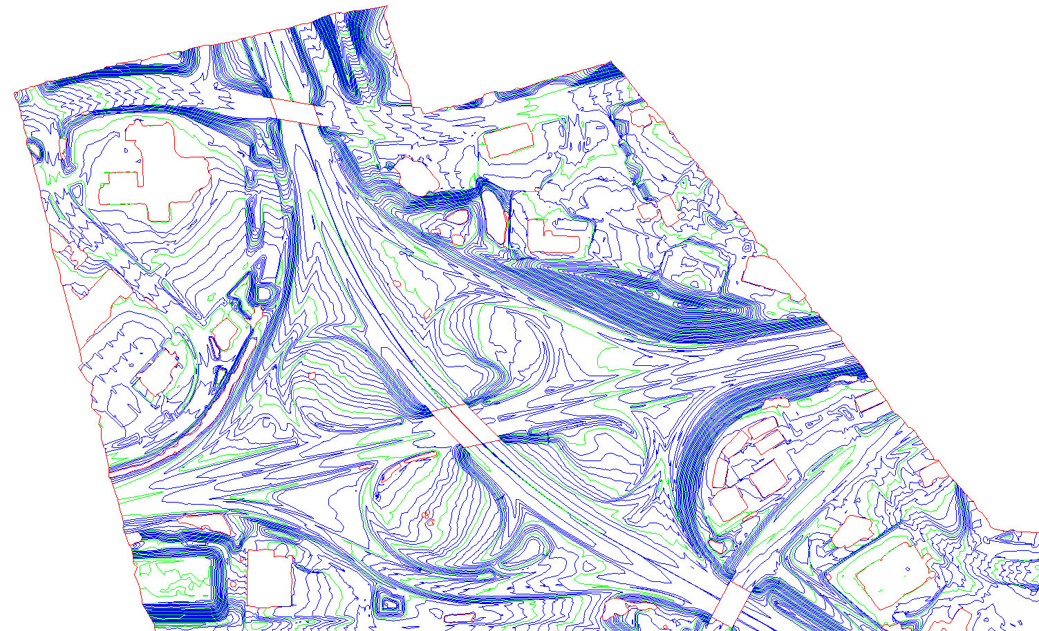

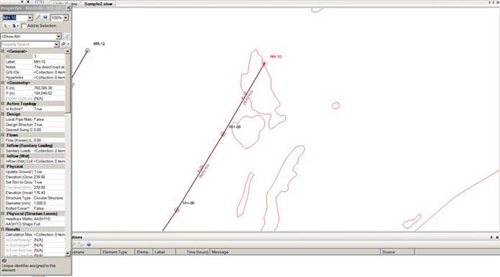

Here is an example of a terrain model's contours and boundary lines.

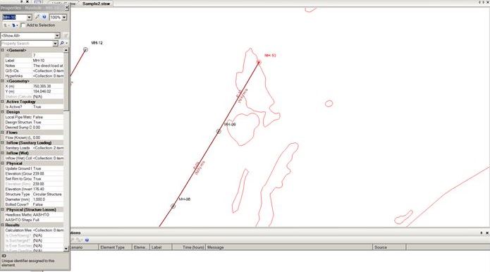

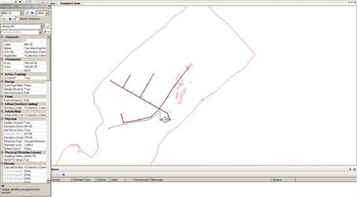

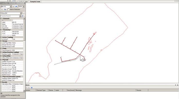

If you look at the MH-10 properties, you will see the ground elevation of 239.88.
If you move MH-10, the ground elevation will get updated by the elevations in the terrain model because the "Update Ground Elevation" is set to True.

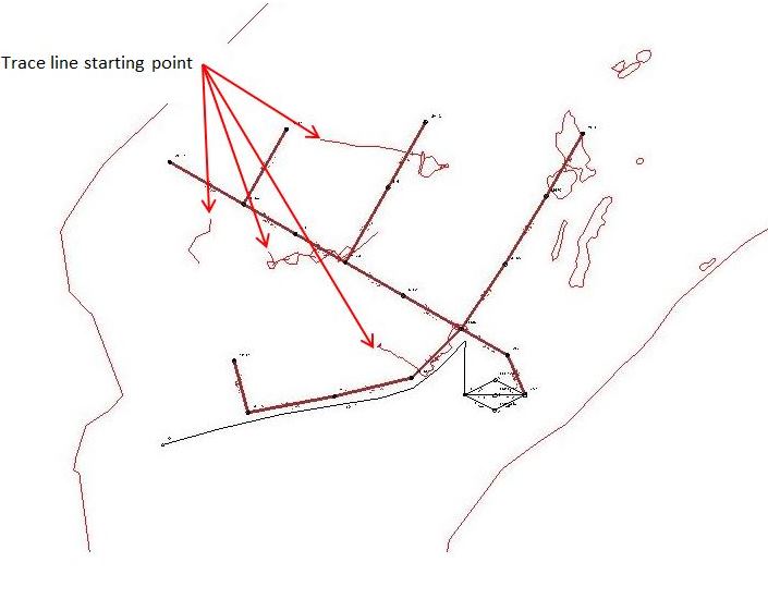

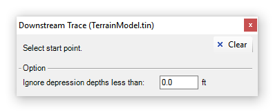

Another feature is the Downstream Trace (also known as water drop trace).  You can pick points within the terrain model and it will trace downstream to the lowest point.
You will get the following dialogue box.  You will need to put in the value for the option if you want to ignore any depressions less than a certain dimension.
After you set the value, you can select a point in the model within the terrain boundary and the software will draw the trace lines.
Note: currently (as of 10.00.00.40) the downstream trace feature will not display the length or slope of the trace line. Enhancement 677454 was filed for the ability to do this in a future release. In the meantime if you need to see the length and slope for purposes of determining the time of concentration (Tc), you can trace over the line with the Measure tool to determine the length, and then the slope determined based on that length and the elevations at the ends (as seen using the Z coordinate mouse-over mentioned further above).

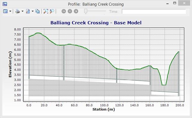

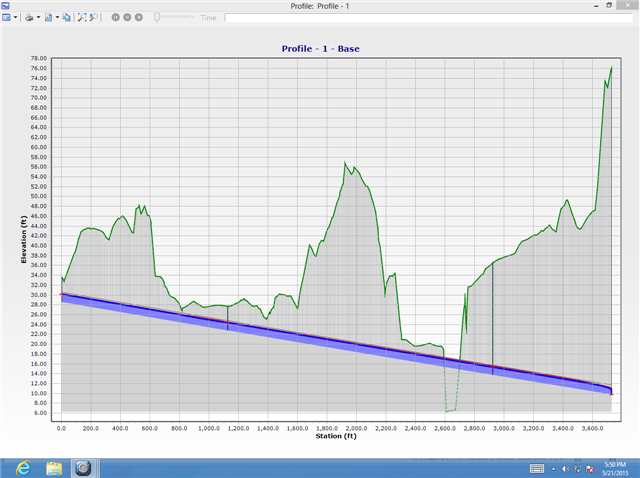

Viewing Terrain Models in Profiles
Starting with V8i SELECTseries 5 (and greater, including CONNECT Edition), profiles will display ground elevations as per the active terrain model:

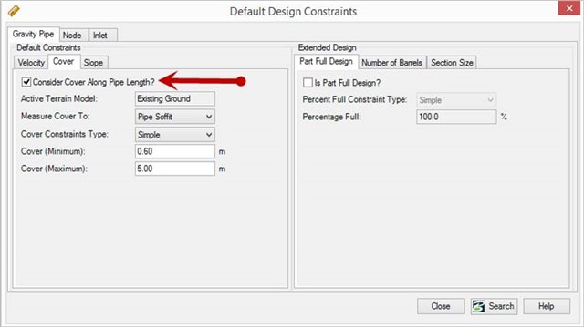

Using Terrain Models to enable constraint based design to consider cover along the pipe length
Starting with V8i SELECTseries 5 of the Storm and Sewer products, if you have an active Terrain Model, ground elevations from that model may be used during a Design run to consider cover along the pipe's length.  If you want to use this option check "Consider Cover Along Pipe Length?" as shown below.
