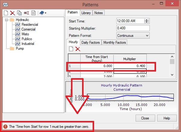

ERROR 173: Time Series (element label)_Inflow_Ts has its data out of sequence.
First, make sure you are using the latest version of the software. The link has details on downloading the latest version: Downloading OpenFlows | Hydraulics and Hydrology software.
If that doesn't help, review any patterns you are using, including for sanitary and wet weather inflows. For instance, if a pattern begins with hour zero, similar to the screenshot below, this error message will be valid. Note that if a starting multiplier for the pattern is entered, also including a row for hour zero may be inaccurate. In addition, make sure the last item in the pattern matches the starting multiplier.
