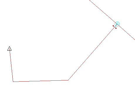

How can I model a flow restriction at an outfall, to limit the maximum flow that the outfall can receive? For example this may represent a pump station or treatment plant that can only receive a certain maximum flow. Flow above that will cause a backup and will be stored in pipes and potentially overflow upstream manholes.

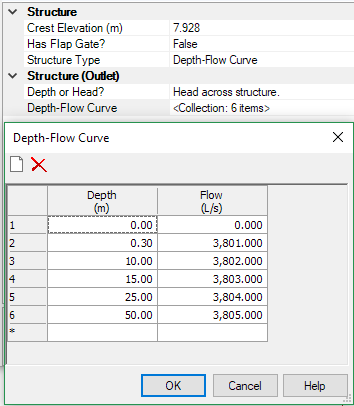

One possible approach to modeling a flow restriction is to use a Start Control Structure on the last conduit before the outfall, with the "Depth-Flow Curve" Structure Type. Configure the table of Depth and flow to model a fixed flow at all depths. For stability purposes, include a zero flow at zero head entry for the first row. For the second row, use a small depth, with the flow equal to the desired flow restriction. Add a few additional rows to cover all possible depths, with a very slight increase in the associated flow rate. For example 3801 L/s, 3802 L/2, 3803 L/s, and so on. Ensure that the "Crest Elevation" in the conduit control structure is set equal to the invert of the flow restriction, and ensure that you select this conduit control structure in the properties of the conduit.
