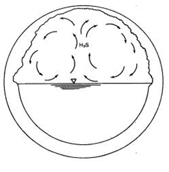

Hydrogen sulfide forms in wastewater collection systems when anoxic conditions exist and results in corrosion, odor and toxicity problems. The rate of formation depends primarily on the strength of the wastewater as characterized by BOD concentration (Biochemical Oxygen Demand) and rate constants for the reactions which are dependent on temperature. Hydrogen sulfide in most commonly a problem in systems with long detention times in warm weather. The hydrogen sulfide calculations assume that sulfate concentration is not limiting.

Note that the calculated H2S produced by the model represents the H2S concentration in the aqueous phase. The amount that escapes to the gas phase depends on the turbulence, and various coefficients in Henry’s Law.
