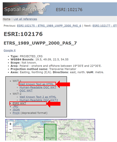

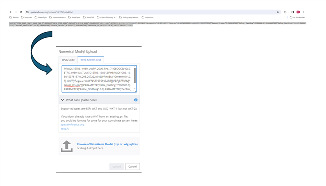

In case this does not work, the user has also the possibility to define the WKT (well-known-text) for that specific EPSG / ESRI code that is not supported. To find for the WKT related with the EPSG or ESRI, please follow the below steps:
After defining the WKT, to change it again the user will need to reupload again a hydraulic model.
Note: In case the model refers to a specific user coordinate system which there is not a compatible EPSG or ESRI code, you can also define a custom WKT.
