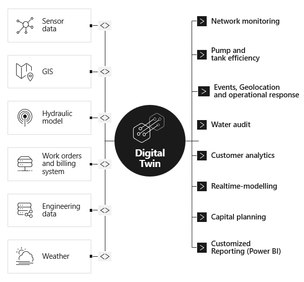

Available Modules and Data Requirements
OpenFlows WaterSight uses powerful Artificial Inteligence (AI) algorithms together with advanced analytics to bring new insights to water utilities. Based on the data that is available and integrated into the solution, different modules and capabilities become available. The Figure below illustrates a high level diagram of the main data source inputs (on the left) and main modules/capabilities (on the right).
Table below describes in more detail each module/capability and main data requirements:
| Available Modules |
Description |
Required data inputs |
| Network Monitoring |
Real time monitoring of any sensor measurement, patterns calculation, forecasts and history navigation |
- Sensor data (historical time series data, real time series data, sensors properties/characteristics) - GIS (pipes and zones) |
| Pump Assessment |
Calculation of pump operating points, efficiencies and costs |
- Sensor data (pump flow, pressure, status, power, VSP speed, etc) - Engineering data (pump curves, best efficiency point, etc) |
| Tank Assessment |
Tank levels monitoring and tank turnover |
- Sensor data (level sensors) - Engineering data (volume, max and min level, tank curves, etc) |
| Events and Alerts |
Generation of alerts and events management |
- Sensor data (historical time series data, real time series data, sensors properties/characteristics) |
| Geolocation of leaks |
Identification of the most likely spots of leaks inside a zone |
- Sensor data (real time series data, sensors properties/characteristics) - Hydraulic Model |
| Operational Response simulation |
Simulation of emergency events such as pipe breaks, pump shutdowns, fires or big demands, valve operations. Understanding impacts of those events (affected customers, low pressures, etc) |
- Hydraulic Model |
| Water Audit |
Water Balance calculations per zone, including water losses calculation and division between real and apparent losses, and MNF indicators |
- Sensor data (historical flow time series data) - Zones properties (inflows and outflows) - GIS (zones polygons) - Customer meter characteristics (location) - Billing data (monthly billings for each customer meter) |
| Customer Analytics |
Analysis of customer meters per clusters/groups (age, type, brand, average consumption, zone, etc) |
- Customer meter characteristics (location, DN, brand, type, installation date, etc) - Billing data (monthly billings for each customer meter) |
| Real time Modelling |
Real time modelling of the system (model boundary conditions automatically fed from real sensors measurements) |
- Sensor data (historical time series data, real time series data, sensors properties/characteristics) - Hydraulic Model |
| Capital Planning |
Supporting identification of priority pipes for rehabilitation |
GIS (pipes, zones, others) Hydraulic Model |
| Customized Reports |
Creation of customizable reports that can be included in WaterSight |
Power BI licence |

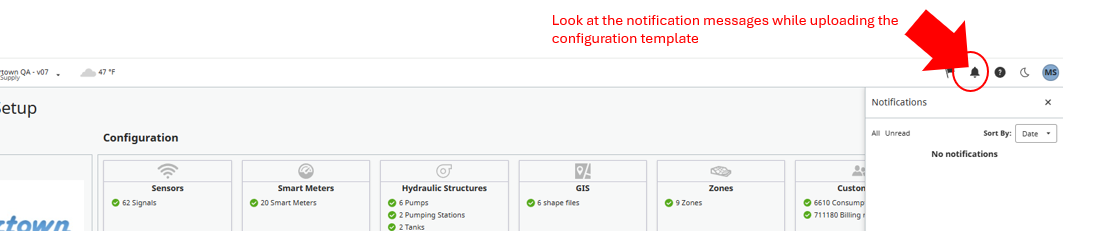

When uploading the configuration template take attention to potential errors or warnings that will be listed under the notification bell icon. In case there are issues during the template upload, those messages usually provide more detail about the type of error.
Note: In the Configuration Excel file please make sure that the excel tab named "Sensors" remains with its original name and that the names of the columns headers are also not changed and remain equal to the original names; otherwise there will be an error when uploading the template file into WaterSight.
Please also note that the template is only used to bring every sensor property but not the time series values. The time series values should be automatically brought to WaterSight in near real time, after the sensor connection has been set up. Please see subchapter 3.4 below for more information on how to set the connection.
Note: In the Configuration Excel file please make sure that the excel tab named "Smart meters" remains with its original name and that the names of the columns headers are also not changed and remain equal to the original names; otherwise there will be an error when uploading the template file into WaterSight.

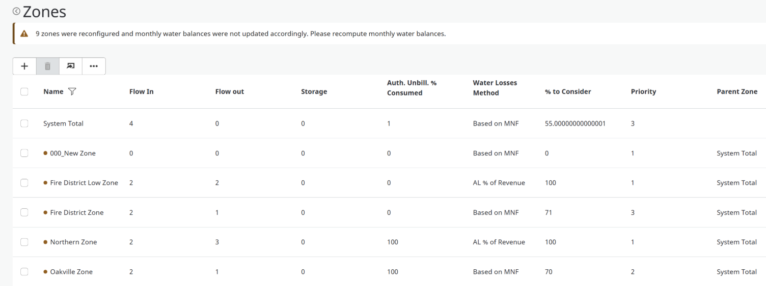

Recomputing Zones Monthly Balance
When zones are created or updated, and if any of the parameters that affects the monthly water balance calculation are changed, then those zones will be marked with a orange dot and a message will be displayed for the user to recompute the monthly water balances. To recompute the monthly water balances click on the (...) button and press recompute all or select the zones for which you want to trigger the monthly water balance calculation.

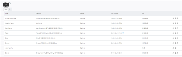

3.6. GIS

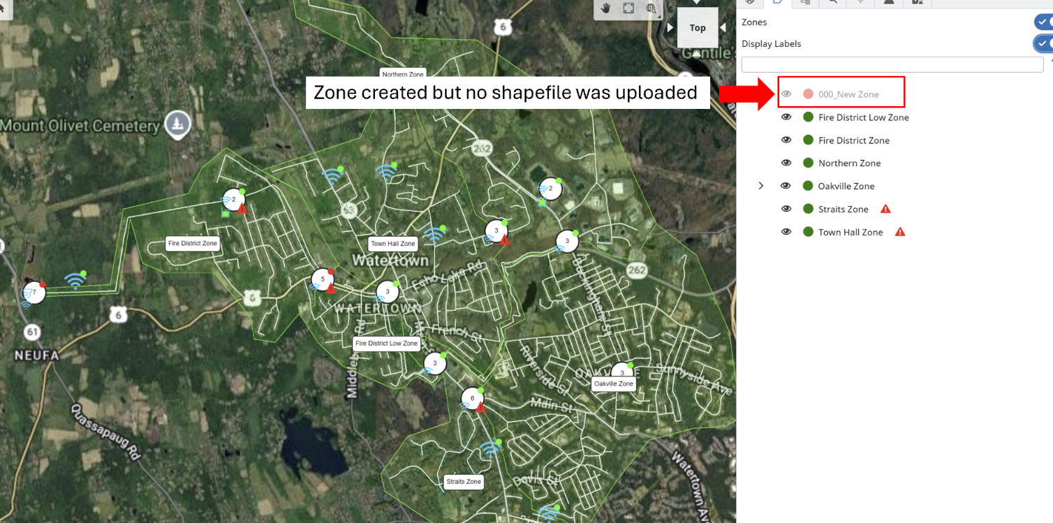

Using any GIS software, create a polygon shapefile for the Zones and export polyline shapefile of the Pipes. See instructions for Uploading Zone Shapefiles and and Uploading Pipe Shapefiles in WaterSight - GIS. Note in particular that the Zone shapefile must include a column called "Name", and the Pipe shapefile should have a column called "ID". It is helpful for search functionality if the Zone name includes the word "Zone" or "DMA". For information about creating zones shapefile, click here.
Please also note that the zone shapefile upload button will only be enabled if zones were previously created (see point 3.4), otherwise it will not be possible to upload the zone shapefile. If zones are created but a zone shapefile is not uploaded, the zones graphs will still display in WaterSight as well as the water balance information, however zones will not display in the map (and will be greyed out in the side panel, see image below). If a zone is created (under Admin >> Zones) and a shapefile is uploaded but the zone name does not exist or does not match the exact same name in Admin >> Zones, it will also not be possible to create the zone geometry and that zone will not be displayed in the map.
The Pipe ID should either be populated to match the Pipe Label or Pipe GIS-ID in a WaterGEMS hydraulic model. Best practice is to use a unique ID from the GIS, software, and associate that to the GIS-ID field within WaterGEMS. This supports multiple GIS-IDs for a single pipe, such as in the case of merging multiple pipe segments into a single model pipe.
Consider adding as many informative fields as possible to the pipe shapefile, such as installation year, material, and other parameters that would be useful for the capital planning assessment module of WaterSight. For more information on how to start with the capital planning module, please click here.
You can optionally add as many additional GIS layers as you like, by directly clicking in the "Add" button on top of the GIS table, in the administration page. These can be layers useful for operations such as the location of critical customers, bursts and also layers useful for capital planning assessment, such as polygons for soil type.
It is also possible to upload other map layers such as from WMS and WMTS sources or even create direct connection to ArcGIS databases. More information can be found on this page, under the Map layers section.
