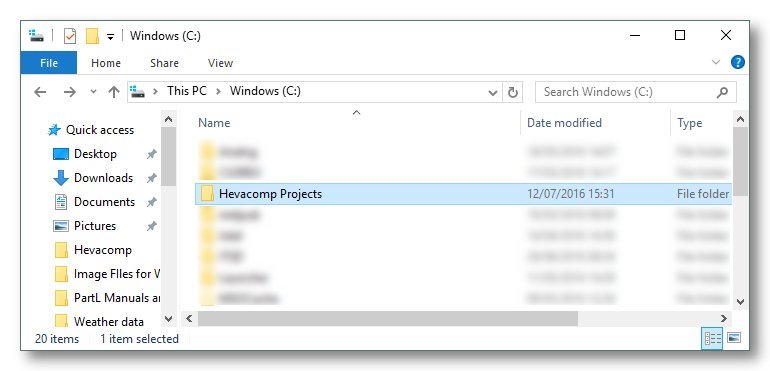

- Locate the Hevacomp Projects folder on your C drive

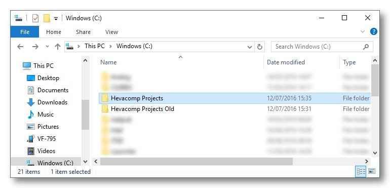

- Rename this Hevacomp Projects Old (you may need admin permissions to do this) and then create a new Hevacomp Projects folder

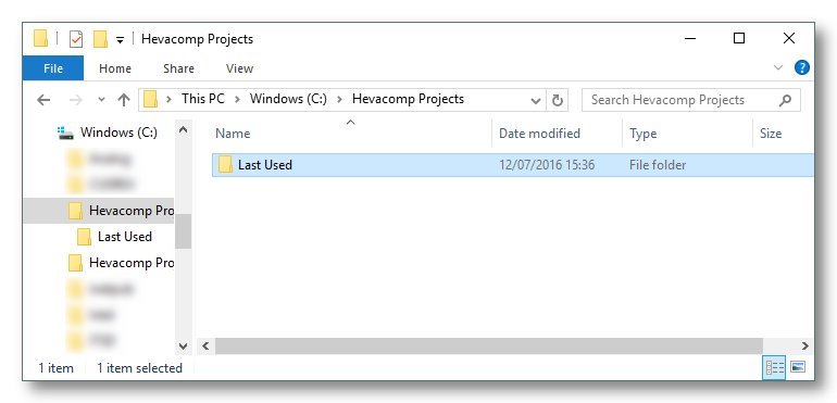

- Within the new Hevacomp Projects folder, create a Last Used folder

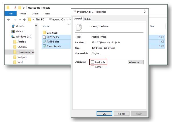

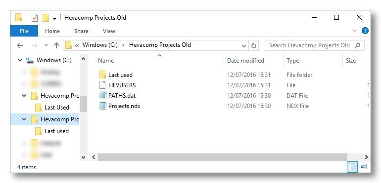

- Copy the files from the Hevacomp Project Old folder into the Hevacomp Project folder - you may see more or less files than this
- Ensure that your copied files are not set to Read Only. Select all the files, right click the selection and choose properties. If the read only box is ticked, then untick and ensure all files are changed.

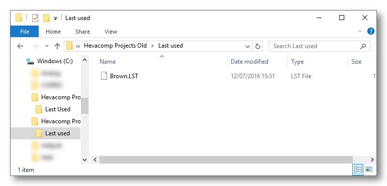

- Copy the files from Hevacomp Projects Old/Last Used into Hevacomp Projects/Last Used - you may see more or less files than this, and ensure the Read Only flag is not selected for these files, too.
