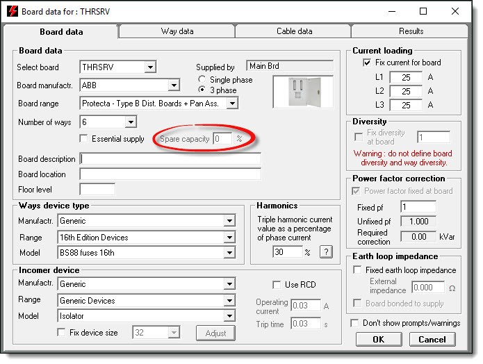

How do I set up Spare Capacity for a board?
 Product(s):<Product name to go in here>
 Version(s):V8i (version number)
 Environment:N/A
 Area:N/A
 Subarea:N/A
The Spare Capacity fields are greyed out when board data is edited.
The Spare Capacity field is designed to allow an extra percentage loading to be applied to a board. If you fix the board current then this option becomes obsolete and is turned off. If you wish to set a spare capacity then you cannot fix the current load.
