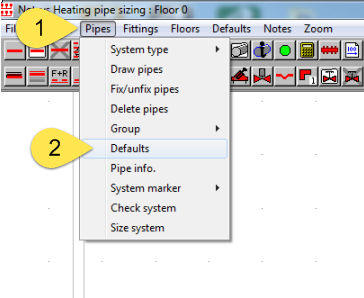

To display section numbers in a pipework project firstly select Pipes > Defaults:

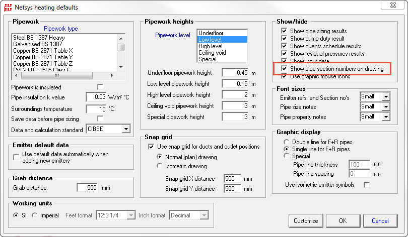

Then, enable the 'Show pipe section numbers on drawing' option, as below.

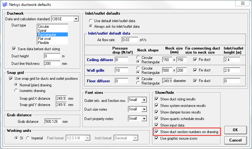

 Similarly, for Ductwork projects simply select Ducts > Defaults, and then select the option to 'Show duct section numbers on drawing':
