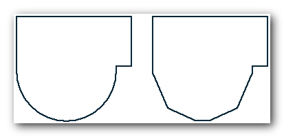

- Reducing the number of polylines - Circular surfaces
A number of angled poly-lines can be used to reasonably accurately define a curved surface. However this can adversely affect the speed of the calculation as the number of poly-lines can be excessive. It is possible to produce a reasonable facsimile of the curved surface by using the minimum number of polylines without compromising the room volume.

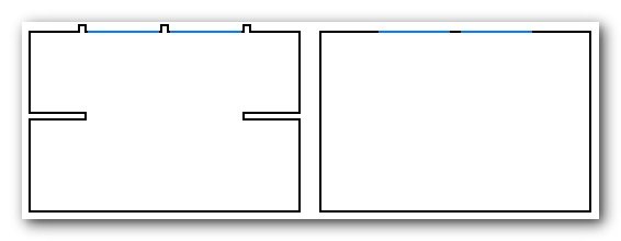

- Reducing the number of polylines - Room Outlines
You can often remove unnecessary convolutions from a room outline without compromising the volume of the room or the surface area of a wall. As this reduces the number of poly-lines in the room, this will help with the speed of calculation.

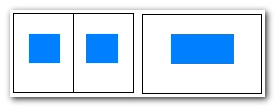

- Reducing the number of polylines - External walls and windows
Care should be considered when designing external walls. Splitting a wall into more sections than Is required or including multiple windows on a façade may not be necessary. As seen here, these can be combined and will help reduce the number of polylines overall.
