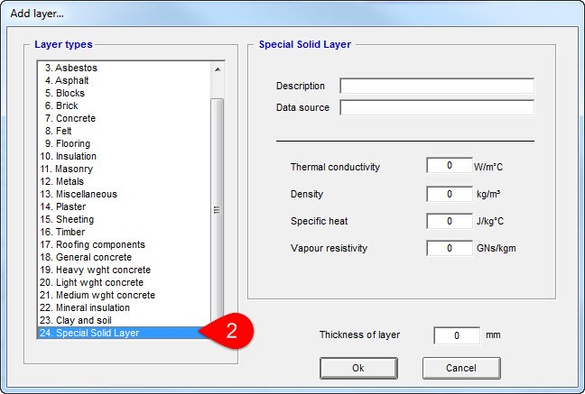

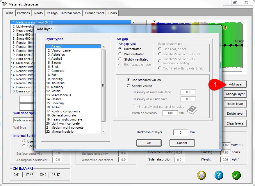

To define a custom material, firstly select Add layer:
Then, scroll down the list of Layer types and select Special Solid Layer. This will allow you to define the thermal properties of your custom material.
