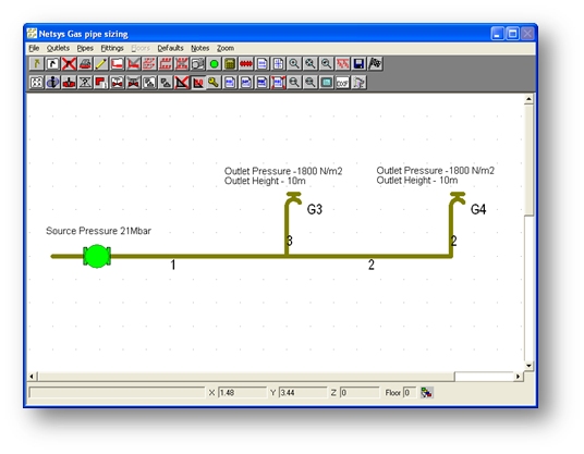

This document explains how the buoyancy effect is considered in the Residual pressure report in the Netsys Gas program. Consider this small Netsys Gas system:

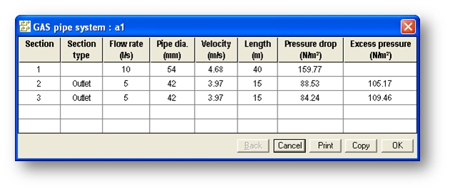

This system will produce the following sizing results:

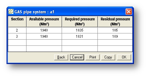

And the Residual Pressures report for the system:
The columns in the above report are calculated with the following methods:
Available pressure = Source pressure - Pressure drop in section
Required pressure = Outlet pressure + Section pressure drop - Buoyancy effect
Residual pressure = Available pressure - Required pressure

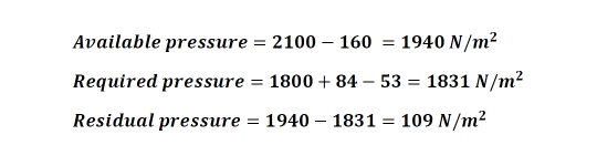

Where the buoyancy effect is calculated using this formula:
The example system above uses Natural Gas with a buoyancy of 0.68
So for Section 3 in our example Gas layout:
The residual pressures report shows figures rounded to whole numbers.
This is reflected in the calculation above.
