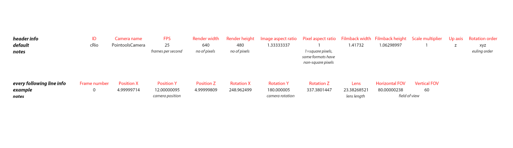

Camera paths - each value explained
A few people are asking about the meaning of each variable in the camera path file recently. This is becoming popular due to more of our customers wanting to recreate the path of their mobile scanning systems within Pointools, either for an added sense of realism or to directly compare the point cloud to a video stream.
This is just to explain what you get out of Pointools 'export camera path' tool. The values under each heading are from my example file, with everything as default.
right-click and save file if you can't read it
