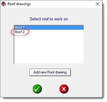

From within Design Database, identify the roof name that you wish to delete. In this case we are considering "Roof 2"

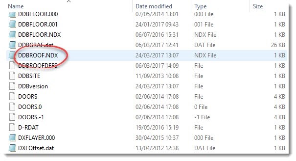

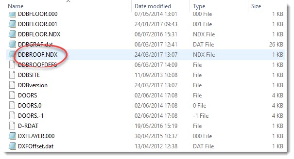

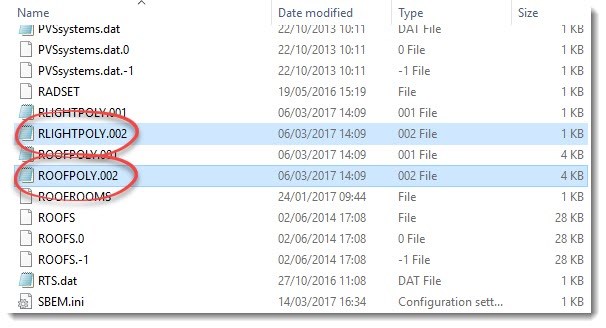

Using File Explorer, navigate into your project folder, and identify the DDBROOF.NDX file.

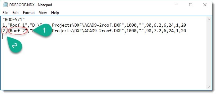

 Open this file in Notepad, and examine the data for the roof you wish to delete (1). Take note of the number to the left of the roof name (2)

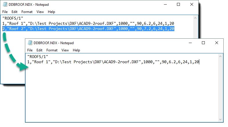

 Fully delete the line that contains your roof name. Do not make any other changes to the file other than removing the line.
 Save the file back into your project. If you are asked if you wish to over write the existing file, select yes.

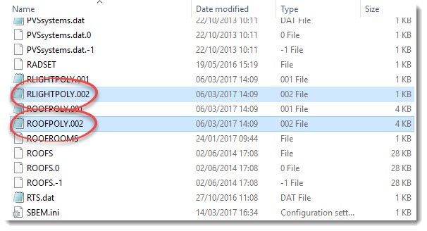

Examine your project folder to locate the ROOFPOLY.* and RLIGHTPOLY.* files. Identify the files that have the same extension as the number noted in the point above. In this instance, the number was 2, so the extension we are looking for is .002. If the number had been 20, you would be looking for an extension of .020
 Delete the corresponding ROOFPOLY and RLIGHTPOLY files. You should now be able to load your project back into Design Database, with the offending roof removed.
