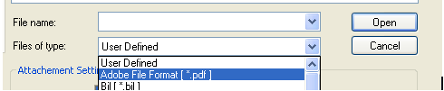

·         Raster Manager > File > Attach
·         Select Adobe File Format
When you click on the PDF raster image name in Raster Manager you will get Multi-Page list of PDF page numbers in the bottom right corner of the Attach Raster Reference box.
·         Select the PDF page number that you want to attach

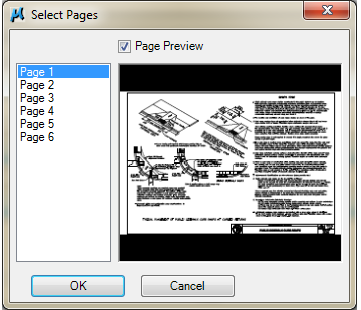

On the right side on the lower section make sure Open Settings Dialog is marked
Right click PDF file name under Attachments > you will get Page Selection option
·         Click Page Selection and it will show a list of page numbers in the PDF file
·         Select PDF page number to be attached
