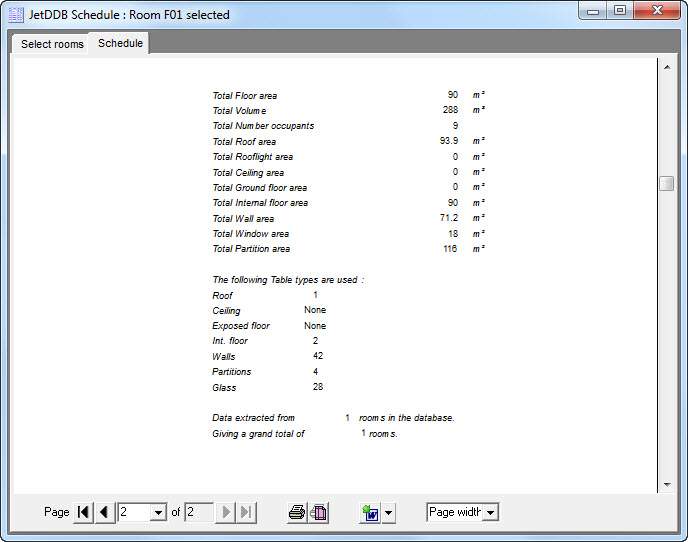

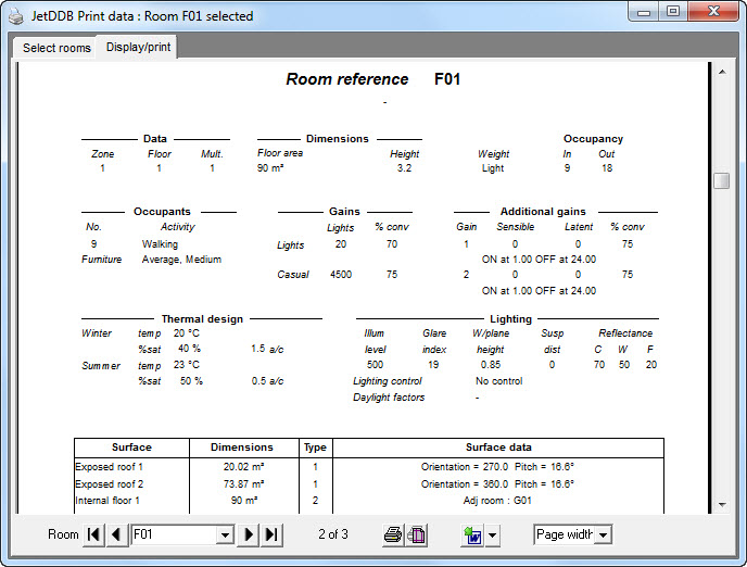

The Schedule and Print functions offer comprehensive reports detailing all aspects of the building model.
Schedule will display data for each included room, showing the room reference, zone, floor, number off and description.
In addition, summary statistics for the included rooms will be shown, including total floor area, volume, exposed wall and window area, etc. A list of all construction types currently in use (ie walls, partitions, floors, ceiling and glazing) will be displayed, this is useful to check that you have not inadvertently specified different construction types in some rooms.
