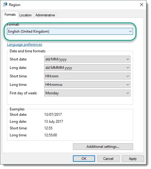

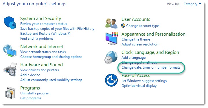

Open your control panel and select "Change date, time and number fomat"
Ensure that your date and time settings are set to English (United Kingdom)
