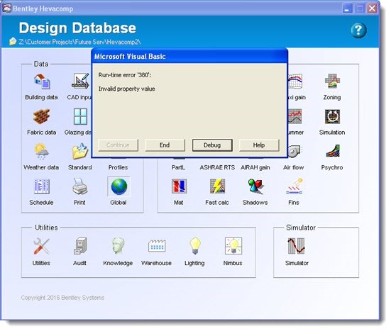

When entering the Global Change program, a Run Time Error 380 appears. Clicking OK on the error message closes the program.
This error is usually indicative of damaged Fabric files. You can check for this by reloading the project and using the Fabric program.

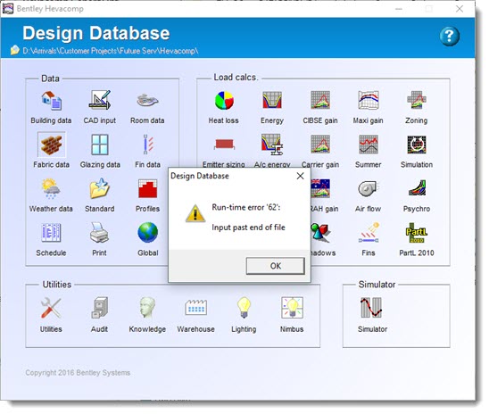

If you recieve an Input Past End error:

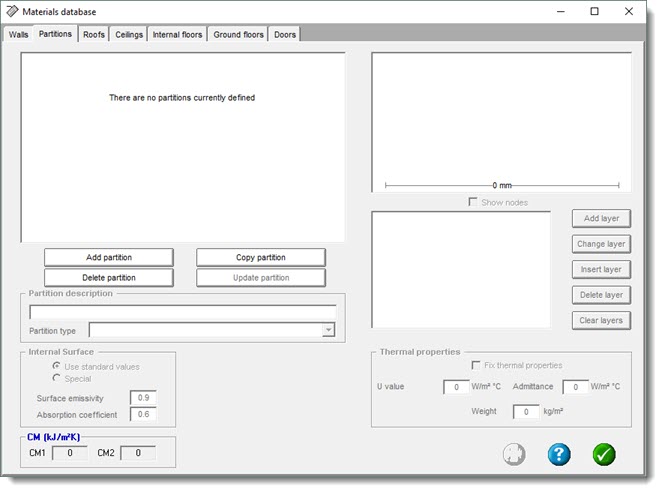

 Or have empty fabric lists:
 then your Fabric data is corrupt and needs regenerating.
The quickest solution is to delete all the existing Fabric files from the project and let Design Database replace them with the default files next time you open the project.
You should delete these files and these files only:
LTABSCEILINGSEFLOORSFINS
FLOORSGFLOORSGLAZINGINTERNAL.S
 ROOFSWALLS
The next time you open the project these files be regenerated. If you had previously created custom Fabric data, you will need to re-enter it.
