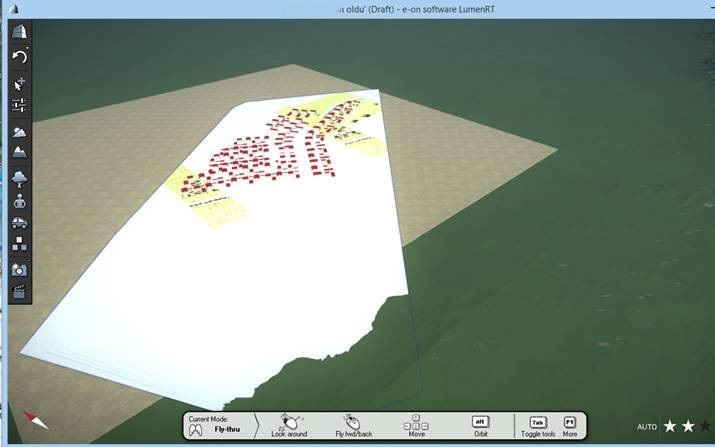

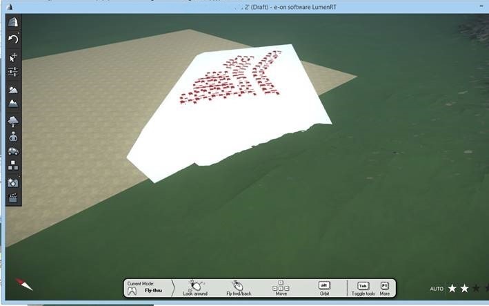

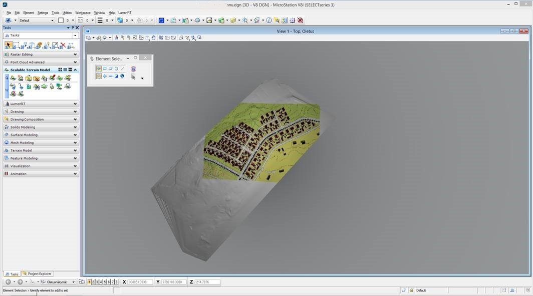

I have Descartes for MicroStation 08.11.09.601 and Lumen RT installed with update  15.50.22.44. This is a STM file with picture wrapped:
When I export to Lumen RT:
1)      Sometime the pictures is visible a bit
2)      Sometime the pictures is not visible at all
3)      stm file is moved every time it is exported

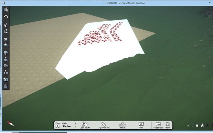

Steps to Resolve
Please download the *.rar attached containing how to fix this issue. Then follow these instructions:
1) Close Microstation and LumenRT
2) Rename the folder C:\Program Files\e-on software\LumenRT 2015\LumenRT\Export\Microstation to Microstation_old
3) Unrar the enclosed rar archive (Microstation_patch.rar) and place the folder Microstation into the folder: C:\Program Files\e-on software\LumenRT 2015\LumenRT\Export
4) Restart Microstation and try exporting again
communities.bentley.com/.../Microstation.rar
