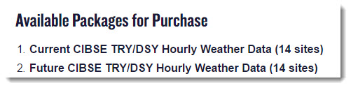

Either of the following weather packages can be purchased from CIBSE (see here) and installed into Bentley Hevacomp. (Please note that the Combined Data Package is incompatible).
