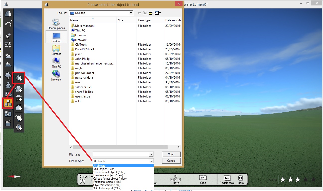

You can import/add your objects in a LumenRT scene by using one of the following file formats:
Supported import formats:
- Large Objects *.lob (delivered with the software under the following categories: Plants, Characters, Cars, Indoor objects, Outdoor objects, Buildings, Lights. They are the "Contents" of LumenRT))
- Vue objects *.vob
- Shade format objects *.shd
- Raw format objects *.raw
- Collada format objects *.dae
- Fbx format objects *.fbx
- Objects Wavefront *.obj
- 3D studio export *.3ds
