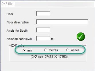

- Import the DXF into Hevacomp using the correct units. The software will automatically detect the units used in your DXF so we would strongly advise leaving this as default, in most cases. Please note that your DXF background may appear inverted if incorrect units are selected - see here for further information.
