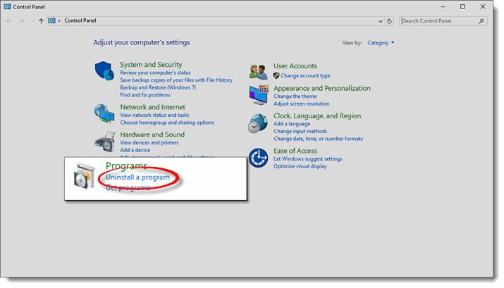

1] From the Control Panel, select Uninstall a program

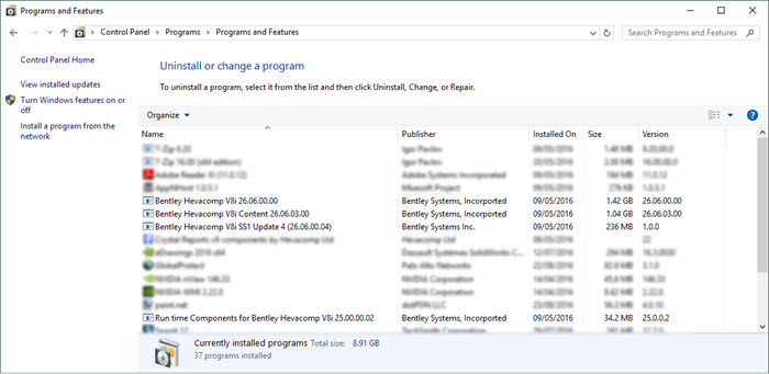

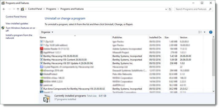

2] From the list of available programs, uninstall all components that reference Bentley Hevacomp or Hevacomp. Note that you can leave Crystal Reports extant.
