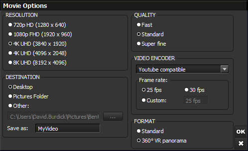

Exporting your animation out as a 360 degree spherical video is as easy as entering the correct settings during export. Once you've completed creating your video and now want to export, ensure that the following options are enabled:
It is recommended that you use the "YouTube" video encoder when creating 360 VR output since this will inject the necessary metadata into the mp4 file in order for YouTube and VR headsets to automatically recognize the 360 format. Alternatively, you can manually inject the metadata into your mp4 file by using the Google metadata injector found here: github.com/.../360.Video.Metadata.Tool.win.zip
