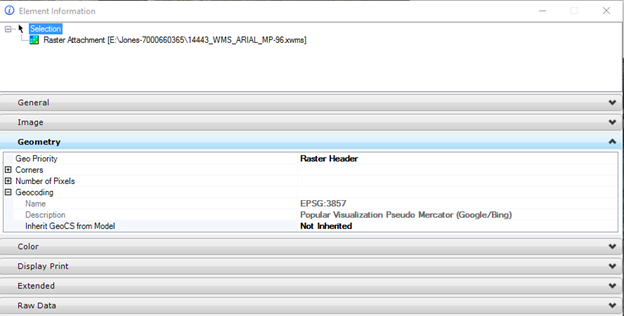

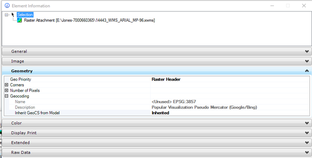

·         Double click WMS image name in Raster Manager.  This will bring up an Element Information box
·         Under Geometry > Geocoding change the column "Inherit GeoCS From Model" to Inherited
·         NOTE:  This will change the location of you WMS image in your DGN file
·         Clip the WMS.
·         Under Geometry > Geocoding change the column "Inherit GeoCS From Model" to Not Inherited
