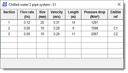

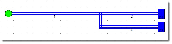

If your pipe schematic is composed wholly of twin pipe
 Your pipe report will show the combined flow and return length of the pipe.

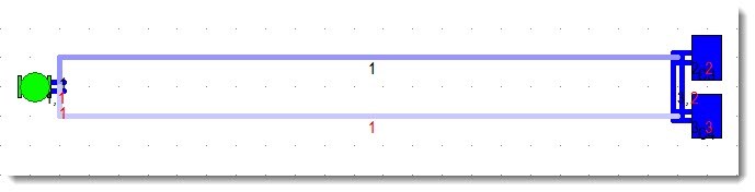

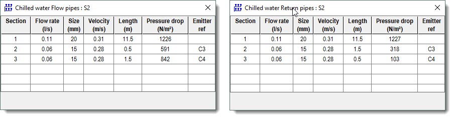

 Combined Twin pipe, flow and return network

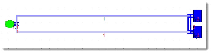

If your schematic is composed of a mixture of flow, return and twin pipe
 Pipe notes will show flow pipe numbers in black, and return pipe numbers in red. Twin pipe is reflected in both reports.
