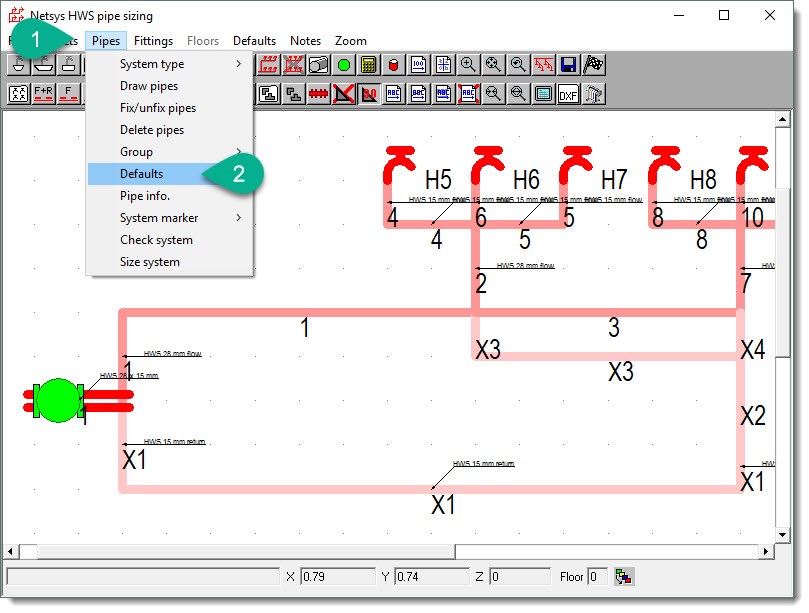

You may wish to adjust how the snap grid works while drawing your schematic.
From the menu bar, select the Pipes menu (1) then the Defaults option (2)
From the Defaults dialog, make adjustments to the grid, or even turn it off (3)
You can also set the grab distance to make connecting sections easier.
We recommend making any changes before starting your schematic.
