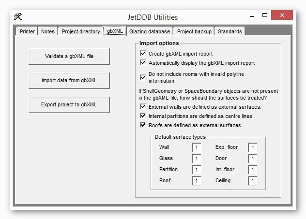

The import feature can be found in the Utilities program

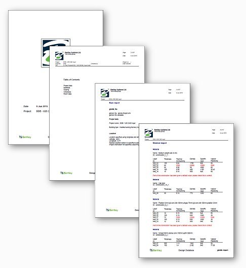

The program offers a number of options to help with the import function; Default surface types can be specified and invalid polylines can be discarded, for example. The import function will attempt to error correct the drawing as it is loaded and a comprehensive import document will be created detailing any problems with the gbXML file.
Any serious errors reported by this document should be fixed in the original model and the gbXML created again, for another attempt at importing.

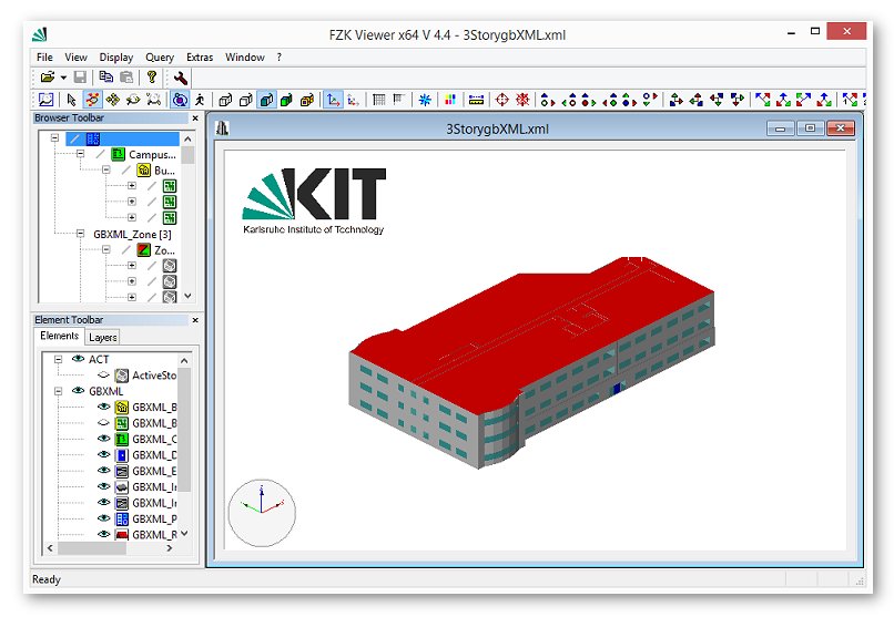

The Import Document created by Design Database may help with this, and we have found a very useful debugging tool in the FZK Viewer from the Karlsruhe Institute of Technology. As this program does not attempt to create a working model it allows you to view the gbXML model as simple polylines. You can quickly identify where problems are in the model and use this information to correct your original model.
The Karlsruhe Institute of Technology FZK viewer can be downloaded from here.
