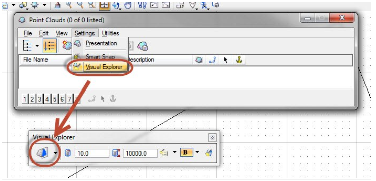

How to activate cursor tracking in different views (option to see the movement of the cursor/pointer in multiple views?
Option 1 Bentley Descartes SS3
  1. Open Point Cloud
  2. Go to settings
  3. Visual Explorer
  4. Use First button to Enable Visual explorer
Option 2 Bentley Descartes SS4, SS5
Go to Tools menu\Point cloud Advanced\ Visual Explorer
First button to Enable Visual Explorer
