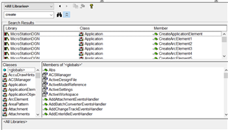

The alternate method to create elements are functions starting with “create”. To search for such “Create*” functions we can use the help file or directly browse in the MicroStation object library. From the VBA Editor with F2 we can switch from Source Code display to an Explorer like display of a complete list of all classes, functions, methods and properties. F7 brings you back to source code display.
The first view of the object library may look like this:
By default the content of <All libraries> is displayed. You may select here to get a filtered content of a specific library:
“MicroStationDGN” – list all classes added with MicroStation “VBA” – list all base functionality from VBA

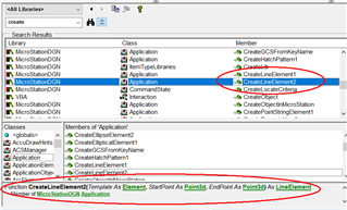

The list may provide more libraries from other application like Excel, if these libraries are referenced to this project (See Tools > References) A search for “create” in the library returns a long list with functions. During scrolling down there should be 2 functions to create lines: CreateLineElement1 and CreateLineElement2.
A click on the selection provides details  about the declaration of the function:
This function requires 2 points to create a line, which we then may place into the drawing. A VBA code example using this function may look like this:

A brief description of this subroutine: The function CreateLineElement2 takes 2 points and returns an element of Type LineElement. The method .AddElement is finally used to add this new created element into the active model of the active drawing file.
