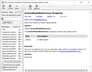

E.g. the open VBA Editor the cursor is positioned on a MicroStation keyword, like done here with ActiveModelReference:
The F1 context sensitive help open the MicroStatioNVBA.chm and jumps to the help for this keyword, like this:

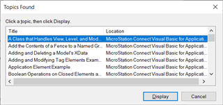

The blue link “Example” additionally provides VBA code examples to demonstrate how to use the command:
In this example this dialog opens and provides a list of code examples:

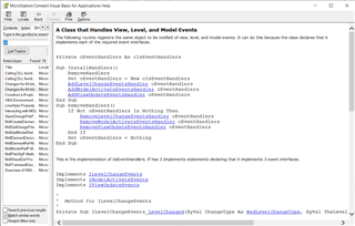

The first selected example provides a complete code example:

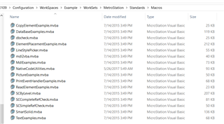

With the MicroStation MetroStation Workset example a set of VBA projects are installed to cover themes not all covered with the help system:
