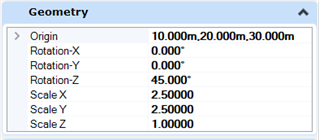

After the cell is placed the properties dialog shows the expected value:
