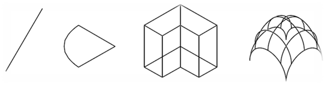

After understanding some of the basics above, we started to write code to generate elements.
1. Edit the HelloWorld.cpp file. The final result is as follows:

Explanation:
2. Type bmake -a in the MicroStation Developer Shell to generate the final HelloWorld.ma and HelloWorld.dll.
3. Start MicroStation, open or create a new 3D model, type MDL LOAD HelloWorld in the input command field and press Enter to generate the figure shown below. This graphic is the effect seen in the ISO view.
