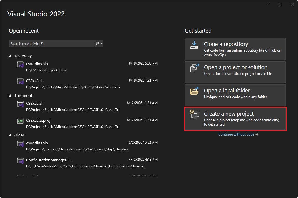

  1. Launch Visual Studio
      Select Visual Studio 2022 (right click and Run as administrator).

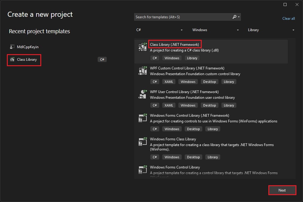

  1. Create new project
      In Visual Studio 2022, select “Create a new project”.
       In the “Create a new project” form,
Note: The Class Library may have multiple options, select the correct type “Class Library (.NET Framework)”, a C# class library (.dll) as shown below.

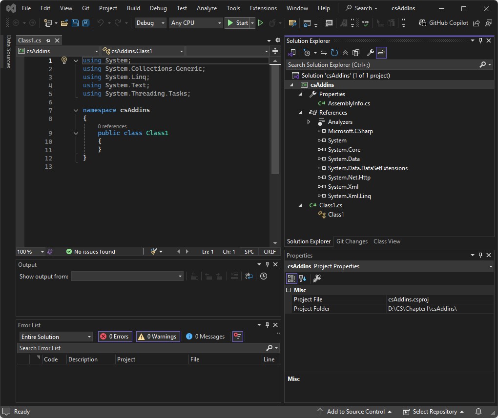

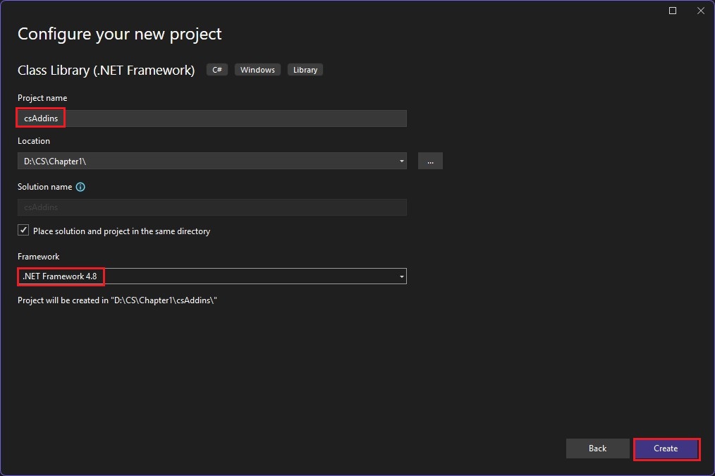

       In the “Configure your new project” form,
        On the left is the automatically generated C# code, and on the right is the Solution Explorer form.

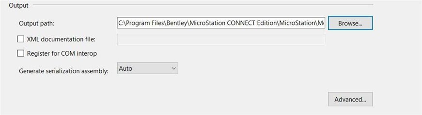

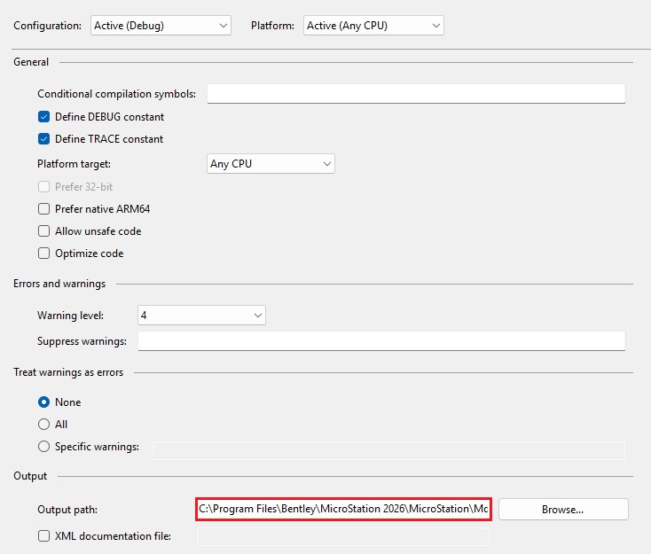

  1. Set Add-in DLL path
      In the Solution Explorer,
  C:\Program Files\Bentley\MicroStation 2026\MicroStation\Mdlapps\
        Note: By default, MicroStation searches for Add-ins in the Mdlapps folder.
                 If your Add-in DLL is created in a different location, set the MS_ADDINPATH configuration variable
                   to include the folder containing the DLL before attempting to load it.

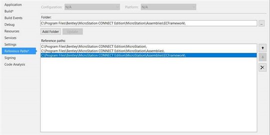

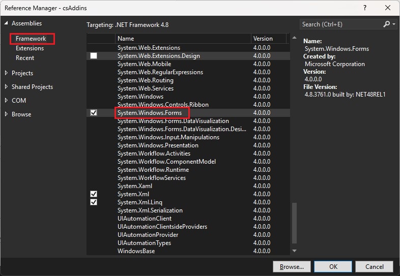

  1. Add References
  System.Windows.Forms

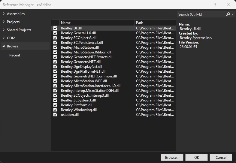

…\MicroStation\ustation.dll
…\MicroStation\Bentley.GeometryNET.dll
…\MicroStation\Bentley.GeometryNET.Common.dll
…\MicroStation\Bentley.GeometryNET.Structs.dll
…\MicroStation\Bentley.DgnDisplayNet.dll
…\MicroStation\Bentley.DgnPlatformNET.dll
…\MicroStation\Assemblies\Bentley.Interop.MicroStationDGN.dll
…\MicroStation\Assemblies\Bentley.MicroStation.dll
…\MicroStation\Assemblies\Bentley.MicroStation.Interfaces.1.0.dll
…\MicroStation\Assemblies\Bentley.MicroStation.Ribbon.dll
…\MicroStation\Assemblies\Bentley.MicroStation.WPF.dll
…\MicroStation\Assemblies\ECFramework\Bentley.General.1.0.dll
…\MicroStation\Assemblies\ECFramework\Bentley.Platform.dll
…\MicroStation\Assemblies\ECFramework\Bentley.UI.dll
…\MicroStation\Assemblies\ECFramework\Bentley.Windowing.dll
…\MicroStation\Assemblies\ECFramework\Bentley.EC.Persistence3.dll
…\MicroStation\Assemblies\ECFramework\Bentley.ECObjects3.dll
…\MicroStation\Assemblies\ECFramework\Bentley.ECSystem3.dll
…\MicroStation\Assemblies\ECFramework\Bentley.ECObjects.Interop3.dll
          Note: If you only want to load programs and display a “Hello World” dialog box in MicroStation,
                     you can simply refer to the ustation.dll. The Bentley.MstnPlatfomNet.AddIn object is
                     included in this ustation.dll file. However, for future program expansions, including all
                     the above DLLs mean you don’t have to worry about which DLLs to add.
         .NET loads DLLs on demand, so referenced libraries are only loaded when code uses their objects.
         Unused libraries, or code paths that are never executed, will not cause the corresponding DLLs
         to be loaded.
        The final reference list is shown in the figure below:
  1. Rename “Class1.cs”
      Right-click “Class1.cs” in the solution browser and select Rename from the pop-up menu,
      then change “Class1.cs” to “MyAddin.cs”.
      Please select Yes to confirm the rename.
      Note: This step is not required, but it's best to do it.

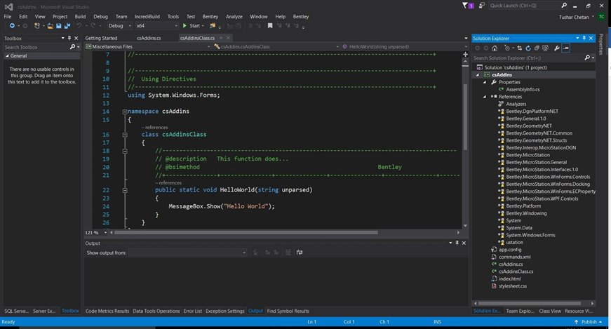

  1. Modify “MyAddins.cs” and add the following code.
using Bentley.MstnPlatformNET;
using System.Windows.Forms;
namespace csAddins
    internal sealed class MyAddin : AddIn
        public static MyAddin Addin = null;
        private MyAddin(System.IntPtr mdlDesc) : base(mdlDesc)
            Addin = this;
        protected override int Run(string[] commandLine)
            MessageBox.Show("Hello World!");
            return 0;
