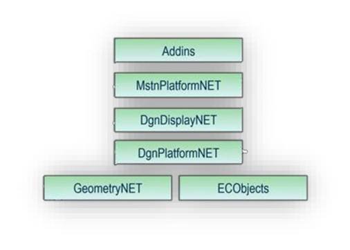

MicroStation supports a variety of element types, which can generally be categorized into graphical and non-graphical elements. In this section, we will focus on creating graphical elements using the MicroStation object model with-in an Add-in.
Understanding how these elements are created is an important step in developing custom MicroStation applications. The following diagram illustrates the overall architecture of a MicroStation Add-in and highlights the key APIs involved. When working with graphical elements, developers primarily interact with the DgnPlatformNET library, which provides the classes and methods required to create, modify, and manage elements within a design file.
To gain a deeper understanding of the MicroStation object model, refer to the SDK documentation available in the following folder:

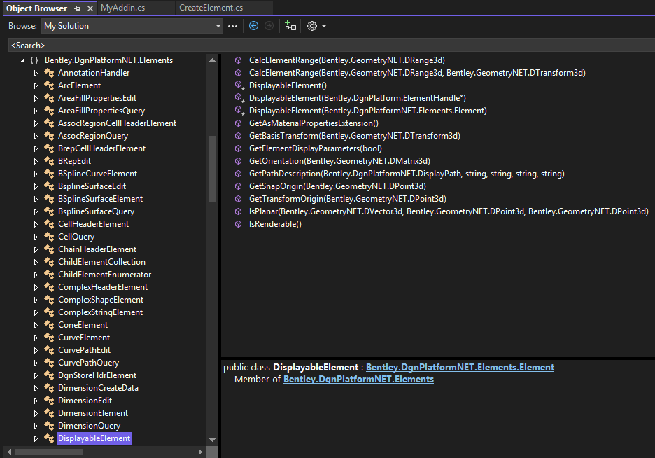

Another useful way to explore the MicroStation object model is through Visual Studio's Object Browser. After adding references to the required MicroStation assemblies, you can browse the complete object hierarchy, inspect available classes and methods, and better understand API relationships.
As shown in the following figure, the Object Browser can be opened by selecting View > Object Browser from the Visual Studio menu.

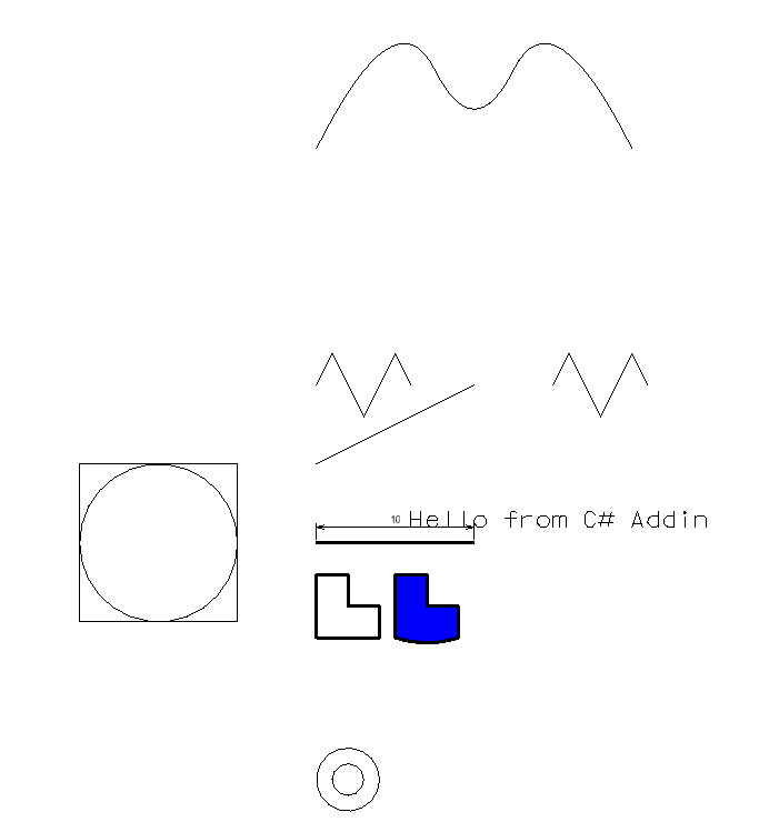

Copy and paste the following code into CreateElement.cs file.

        public static void LineAndLineString1()
            BIM.Application app = Bentley.MstnPlatformNET.InteropServices.Utilities.ComApp;
            BIM.Point3d ptStart = app.Point3dZero();
            BIM.Point3d ptEnd = ptStart;
            ptStart.X = 10;
            BIM.LineElement lineEle = app.CreateLineElement2(null, ref ptStart, ref ptEnd);
            lineEle.Color = 0; lineEle.LineWeight = 2;
            app.ActiveModelReference.AddElement(lineEle);
        public static void LineAndLineString2()
            DgnModel dgnModel = Session.Instance.GetActiveDgnModel();
            ModelInfo modelInfo = dgnModel.GetModelInfo();
            DSegment3d seg = new DSegment3d ( 0 * UorPerMas, 5 * UorPerMas, 0 * UorPerMas,
                                            10 * UorPerMas, 10 * UorPerMas, 0 * UorPerMas);
            LineElement lineEle = new LineElement(dgnModel, null, seg);
            lineEle.AddToModel();
            DPoint3d[] ptArr = new DPoint3d[5];
            ptArr[0] = new DPoint3d(15 * UorPerMas, 10 * UorPerMas, 0 * UorPerMas);
            ptArr[1] = new DPoint3d(16 * UorPerMas, 12 * UorPerMas, 0 * UorPerMas);
            ptArr[2] = new DPoint3d(18 * UorPerMas, 8 * UorPerMas, 0 * UorPerMas);
            ptArr[3] = new DPoint3d(20 * UorPerMas, 12 * UorPerMas, 0 * UorPerMas);
            ptArr[4] = new DPoint3d(21 * UorPerMas, 10 * UorPerMas, 0 * UorPerMas);
            LineStringElement lineStrEle = new LineStringElement(dgnModel, null, ptArr);
            lineStrEle.AddToModel();
        public static void LineAndLineString3()
            ptArr[0] = new DPoint3d(0 * UorPerMas, 10 * UorPerMas, 0 * UorPerMas);
            ptArr[1] = new DPoint3d(1 * UorPerMas, 12 * UorPerMas, 0 * UorPerMas);
            ptArr[2] = new DPoint3d(3 * UorPerMas, 8 * UorPerMas, 0 * UorPerMas);
            ptArr[3] = new DPoint3d(5 * UorPerMas, 12 * UorPerMas, 0 * UorPerMas);
            ptArr[4] = new DPoint3d(6 * UorPerMas, 10 * UorPerMas, 0 * UorPerMas);
            CurvePrimitive curPri = CurvePrimitive.CreateLineString(ptArr);
            Element ele = DraftingElementSchema.ToElement(dgnModel, curPri, null);
            ele.AddToModel();
        public static void ShapeAndComplexShape()
            DPoint3d[] ptArr = new DPoint3d[6];
            ptArr[0] = new DPoint3d(0 * UorPerMas, -6 * UorPerMas, 0 * UorPerMas);
            ptArr[1] = new DPoint3d(0 * UorPerMas, -2 * UorPerMas, 0 * UorPerMas);
            ptArr[2] = new DPoint3d(2 * UorPerMas, -2 * UorPerMas, 0 * UorPerMas);
            ptArr[3] = new DPoint3d(2 * UorPerMas, -4 * UorPerMas, 0 * UorPerMas);
            ptArr[4] = new DPoint3d(4 * UorPerMas, -4 * UorPerMas, 0 * UorPerMas);
            ptArr[5] = new DPoint3d(4 * UorPerMas, -6 * UorPerMas, 0 * UorPerMas);
            ShapeElement shapeEle = new ShapeElement(dgnModel, null, ptArr);
            ElementPropertiesSetter elePropSet = new ElementPropertiesSetter();
            elePropSet.SetColor(0);
            elePropSet.SetWeight(2);
            elePropSet.Apply(shapeEle);
            shapeEle.AddToModel();
            for (int i = 0; i < 6; i++)
                ptArr[i].X += 5 * UorPerMas;
            CurvePrimitive curvePri = CurvePrimitive.CreateLineString(ptArr);
            CurveVector curVec = CurveVector.Create(CurveVector.BoundaryType.Outer);
            curVec.Add(curvePri);
            ptArr[2].Y = -8;
            DEllipse3d ellipse = new DEllipse3d();
            if (DEllipse3d.TryCircularArcFromCenterStartEnd(ptArr[2], ptArr[5], ptArr[0], out ellipse))
                curvePri = CurvePrimitive.CreateArc(ellipse);
                Element eleTemp = DraftingElementSchema.ToElement(dgnModel, curVec, null);
                eleTemp.AddToModel();
                elePropSet.SetColor(1);
                elePropSet.Apply(eleTemp);
        public static void TextString()
            DgnFile dgnFile = Session.Instance.GetActiveDgnFile();
            TextBlockProperties txtBlockProp = new TextBlockProperties(dgnModel);
            txtBlockProp.IsViewIndependent = true;
            ParagraphProperties paraProp = new ParagraphProperties(dgnModel);
            DgnTextStyle txtStyle = DgnTextStyle.GetSettings(dgnFile);
            RunProperties runProp = new RunProperties(txtStyle, dgnModel);
            TextBlock txtBlock = new TextBlock(txtBlockProp, paraProp, runProp, dgnModel);
            txtBlock.AppendText("Hello from C# Addin");
            TextHandlerBase txtHandlerBase = TextHandlerBase.CreateElement(null, txtBlock);
            DTransform3d trans = DTransform3d.Identity;
            trans.Translation = new DVector3d(6 * UorPerMas, 2 * UorPerMas, 3 * UorPerMas);  //UOR unit
            TransformInfo transInfo = new TransformInfo(trans);
            txtHandlerBase.ApplyTransform(transInfo);
            txtHandlerBase.AddToModel();
        public static void Cell()
            ptArr[0] = new DPoint3d(-15 * UorPerMas, -5 * UorPerMas, 0 * UorPerMas);
            ptArr[1] = new DPoint3d(-15 * UorPerMas, 5 * UorPerMas, 0 * UorPerMas);
            ptArr[2] = new DPoint3d(-5 * UorPerMas, 5 * UorPerMas, 0 * UorPerMas);
            ptArr[3] = new DPoint3d(-5 * UorPerMas, -5 * UorPerMas, 0 * UorPerMas);
            ptArr[4] = new DPoint3d(-15 * UorPerMas, -5 * UorPerMas, 0 * UorPerMas);
            DPlacementZX dPlaceZX = DPlacementZX.Identity;
            dPlaceZX.Origin = new DPoint3d(-10 * UorPerMas, 0, 0);
            DEllipse3d ellipse = new DEllipse3d (dPlaceZX, 5 * UorPerMas, 5 * UorPerMas,
                                            Angle.Zero, Angle.TWOPI);
            EllipseElement elliEle = new EllipseElement(dgnModel, null, ellipse);
            List<Element> listEle = new List<Element>();
            listEle.Add(shapeEle);
            listEle.Add(elliEle);
            DPoint3d ptOri = new DPoint3d();
            DMatrix3d rMatrix = DMatrix3d.Identity;
            DPoint3d ptScale = new DPoint3d(1, 1, 1);
            CellHeaderElement cellHeaderEle = new CellHeaderElement(dgnModel, "CellElementSample", ptOri,
                                            rMatrix, listEle);
            cellHeaderEle.AddToModel();
        public static void Dimension()
            double uorPerMast = dgnModel.GetModelInfo().UorPerMaster;
            DimensionStyle dimStyle = new DimensionStyle("DimStyle", dgnFile);
            dimStyle.SetBooleanProp(true, DimStyleProp.Placement_UseStyleAnnotationScale_BOOLINT);
            dimStyle.SetDoubleProp(1, DimStyleProp.Placement_AnnotationScale_DOUBLE);
            dimStyle.SetBooleanProp(true, DimStyleProp.Text_OverrideHeight_BOOLINT);
            dimStyle.SetDistanceProp(0.5 * uorPerMast, DimStyleProp.Text_Height_DISTANCE, dgnModel);
            dimStyle.SetBooleanProp(true, DimStyleProp.Text_OverrideWidth_BOOLINT);
            dimStyle.SetDistanceProp(0.4 * uorPerMast, DimStyleProp.Text_Width_DISTANCE, dgnModel);
            dimStyle.SetBooleanProp(true, DimStyleProp.General_UseMinLeader_BOOLINT);
            dimStyle.SetDoubleProp(0.01, DimStyleProp.Terminator_MinLeader_DOUBLE);
            dimStyle.SetBooleanProp(true, DimStyleProp.Value_AngleMeasure_BOOLINT);
            dimStyle.SetAccuracyProp ((byte)AnglePrecision.Use1Place,
                                            DimStyleProp.Value_AnglePrecision_INTEGER);
            int alignInt = (int)DimStyleProp_General_Alignment.True;
            StatusInt status = dimStyle.SetIntegerProp(alignInt, DimStyleProp.General_Alignment_INTEGER);
            int valueOut;
            dimStyle.GetIntegerProp(out valueOut, DimStyleProp.General_Alignment_INTEGER);
            DgnTextStyle textStyle = new DgnTextStyle("TestStyle", dgnFile);
            LevelId lvlId = Settings.GetLevelIdFromName("Default");
            CreateDimensionCallbacks callbacks = new CreateDimensionCallbacks(dimStyle, textStyle,
                                            new Symbology(),
                                            lvlId, null);
            DimensionElement dimEle = new DimensionElement(dgnModel, callbacks, DimensionType.SizeArrow);
            if (dimEle.IsValid)
                DPoint3d pt1 = DPoint3d.Zero, pt2 = DPoint3d.FromXY(uorPerMast * 10, uorPerMast * 0);
                dimEle.InsertPoint(pt1, null, dimStyle, -1);
                dimEle.InsertPoint(pt2, null, dimStyle, -1);
                dimEle.SetHeight(uorPerMast);
                dimEle.SetRotationMatrix(rMatrix);
                dimEle.AddToModel();
        public static void BsplineCurve()
            ptArr[0] = new DPoint3d(0 * UorPerMas, 25 * UorPerMas, 0 * UorPerMas);
            ptArr[1] = new DPoint3d(5 * UorPerMas, 35 * UorPerMas, 0 * UorPerMas);
            ptArr[2] = new DPoint3d(10 * UorPerMas, 25 * UorPerMas, 0 * UorPerMas);
            ptArr[3] = new DPoint3d(15 * UorPerMas, 35 * UorPerMas, 0 * UorPerMas);
            ptArr[4] = new DPoint3d(20 * UorPerMas, 25 * UorPerMas, 0 * UorPerMas);
            MSBsplineCurve msBsplineCurve = MSBsplineCurve.CreateFromPoles(ptArr, null, null, 3, false, true);
            CurvePrimitive curvePri = CurvePrimitive.CreateBsplineCurve(msBsplineCurve);
            Element ele = DraftingElementSchema.ToElement(dgnModel, curvePri, null);
            ele.AddToModel();
        public static void Cone()
            DPoint3d ptTop = new DPoint3d(2 * UorPerMas, -15 * UorPerMas, 0 * UorPerMas);
            DPoint3d ptBottom = new DPoint3d(2 * UorPerMas, -15 * UorPerMas, 3 * UorPerMas);
            ConeElement coneEle = new ConeElement(dgnModel, null, 2 * UorPerMas, 1 * UorPerMas,
                                            ptTop, ptBottom, rMatrix, true);
            coneEle.AddToModel();
    //Used By Dimension
    class CreateDimensionCallbacks : DimensionCreateData
        private DimensionStyle m_dimStyle;
        private DgnTextStyle m_textStyle;
        private Symbology m_symbology;
        private LevelId m_levelId;
        private DirectionFormatter m_directionFormatter;
        public CreateDimensionCallbacks(DimensionStyle dimStyle, DgnTextStyle textStyle, Symbology symb,

  1. Modify MyAddins.cs file
Open the MyAddins.cs file and modify it as follows:
        protected override int Run(string[] commandLine)
            CreateElement.LineAndLineString1();
            CreateElement.LineAndLineString2();
            CreateElement.LineAndLineString3();
            CreateElement.ShapeAndComplexShape();
            CreateElement.TextString();
            CreateElement.Cell();
            CreateElement.Dimension();
            CreateElement.BsplineCurve();
            CreateElement.Cone();
            return 0;
  1. Build Solution
Under menus, select Build > Build Solution to compile the solution.
  1. Run your Add-in program
You can download the source code for this wiki here.
