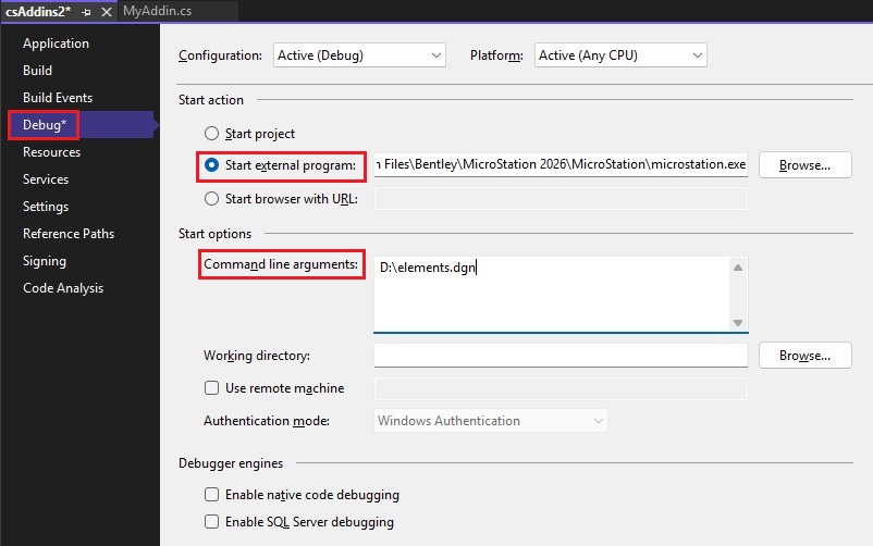

Step 1: Configure the Project
Open your project in Visual Studio.
In the project properties:
  1. Select the Debug page.
  2. Set Start external program to the path of microstation.exe.
C:\Program Files\Bentley\MicroStation 2026\MicroStation\microstation.exe
  1. Enter a test DGN file in the Command ine arguments field.
D:\elements.dgn
Note: This configuration only needs to be completed once for each project.
The following image shows an example configuration.

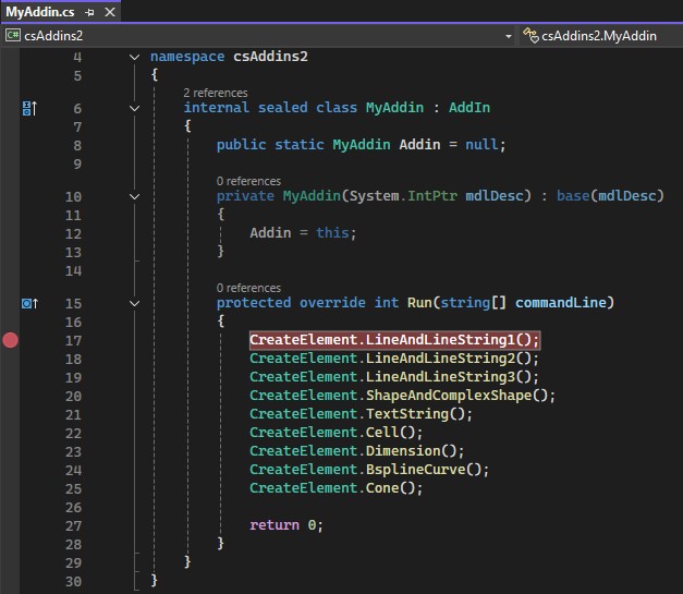

Step 2: Set a Breakpoint
Open MyAddins.cs and locate the following method call:
CreateElement.LineAndLineString1 ();
Click in the left margin next to the line number to set a breakpoint.
When a breakpoint is set:
This tells Visual Studio to pause execution when the code reaches that location.
In Visual Studio, set a breakpoint in:
For detailed instructions, refer to Step 2 of Method 1.

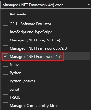

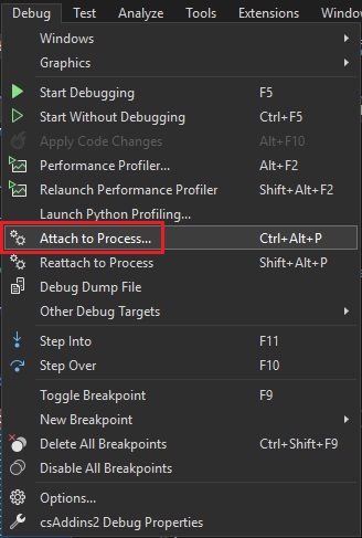

Step 3: Attach Visual Studio to MicroStation
In Visual Studio:
  1. Select Debug > Attach to Process...
  1. Locate microstation.exe in the process list.
  2. Select microstation.exe.
  3. Click Select... beside the Attach to field.
  4. Choose:
Managed (.NET Framework 4.x)
  1. Click OK.
  2. Click Attach.
