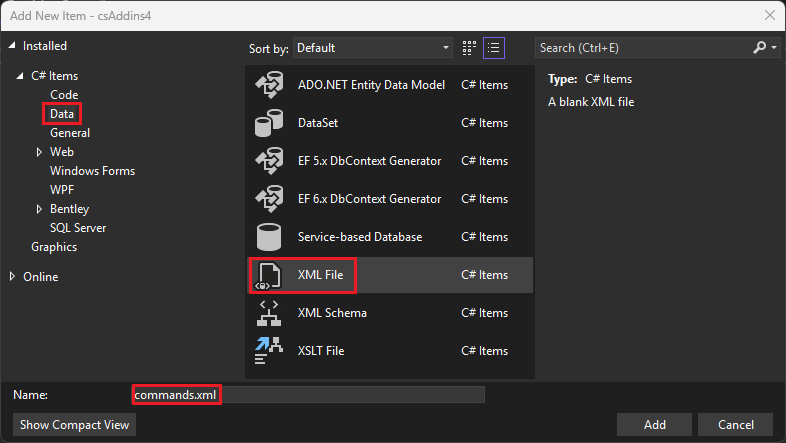

  1. Create a new XML file
Copy and paste the following lines into the commands.xml file.

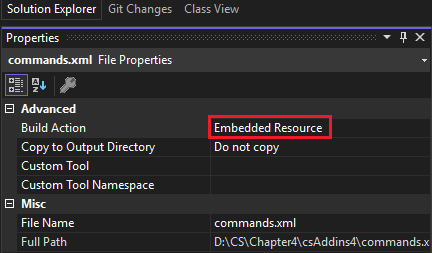

  1. On commands.xml file, set Build Action to Embeded Resource
Right-click command.xml file in Solution Explorer and select Properties menu to open Properties form. Set the Build Action to Embeded Resource. Thus, command.xml file will be embedded into csAddins4.dll file.

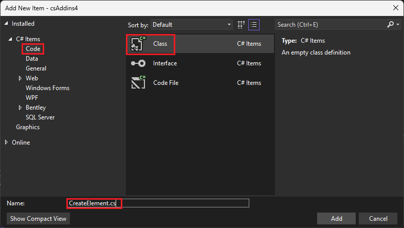

  1. Create a new C# Class
Copy and paste the following lines into the CreateElement.cs file.

  1. Modify MyAddins.cs file
Open the MyAddins.cs file and modify it as follows:
using Bentley.DgnPlatformNET;
using Bentley.MstnPlatformNET;
using System.Windows.Forms;
namespace csAddins4
    [AddIn(MdlTaskID = "csAddins4")]
    internal sealed class MyAddin : AddIn
        public static MyAddin Addin = null;
        private MyAddin(System.IntPtr mdlDesc) : base(mdlDesc)
            Addin = this;
        protected override int Run(string[] commandLine)
            return 0;
  1. Build Solution
Under menus, select Build > Build Solution to compile the solution.
  1. Run your Add-in program
   Graphical elements are successfully created and added to the active model. Try all other CREATEELEMENT key-ins.
You can download the source code for this wiki here.
Prev: Run and debug Add-ins Next: Adding Windows Forms to Add-ins
