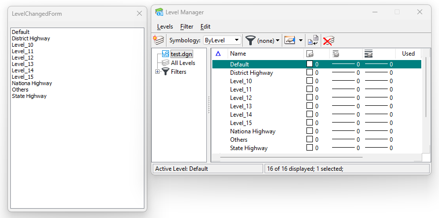

To make these concepts easier to understand, we'll build a simple example using ILevelChangeEvents and NewDesignFileEventHandler.
This example displays all levels from the active DGN file in a dialog box. As you work in the Level Manager, any changes you make, such as adding, deleting, or renaming, level changes are automatically reflected in the dialog. This keeps the displayed information up to date without requiring a manual refresh.
The application also responds when a different DGN file is opened. Whenever a new design file becomes active, the dialog automatically refreshes and displays the levels from the newly opened DGN file.

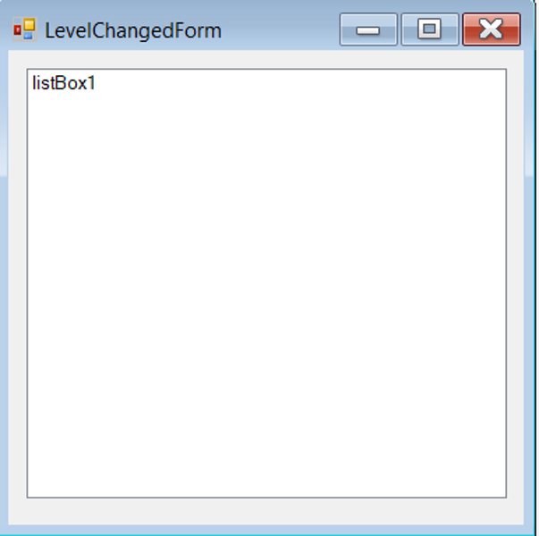

  1. Create a Form LevelChangedForm
Add a List box control to the Form. The form design should resemble the figure shown below.
Form (Name) = LevelChangedForm / FormBorderStyle = FixedDialog / MaximizeBox = False / MinimumBox = False
/ ShowIcon = False / Size = 288,423 / Text = LevelChangedForm
ListBox (Name) = listBox1 / Location = 5,13 / Modifiers = Public / Size = 272,372 / Sorted = True

Open MicroStation's Level Manager, as shown in the figure below. When you add, delete or rename a Level in the Level Manager dialog, the display in our LevelChanged form will also be updated immediately. You can also test further by opening another DGN, and you will find that the content in the LevelChanged form will change, displaying the levels from the new DGN file.
