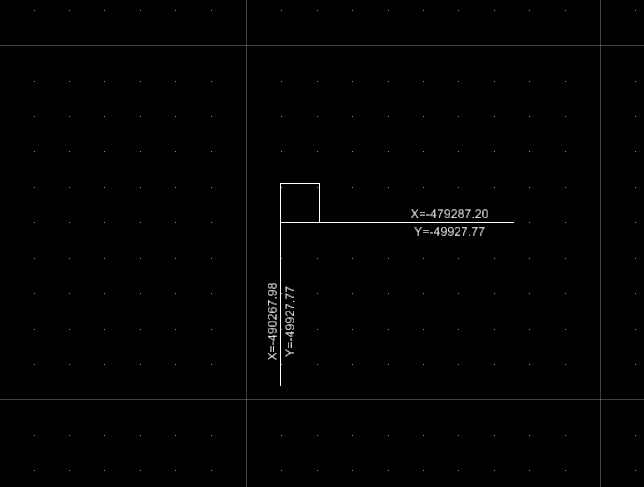

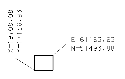

4. In order to realize the function of dynamically labeling the specified point coordinates, let's create a class NoteCoordClass which extends DgnPrimitiveTool. Documents related to this kind of help has not yet announced, but since CE under version Addin framework to NativeCode frame almost parallel, in NativeCode there is a class of the same name, so use this class that we can refer to NativeCode help This class is explained in the documentation ( …\Bentley\MicroStationCONNECTSDK\doc\MicroStationAPI.chm ).
Note: If you encounter any error while using DgnPrimitiveTool class, make sure to add a reference to Bentley.DgnDisplayNet.dll by selecting Project > Add Reference.
using Bentley.DgnPlatformNET;
using Bentley.DgnPlatformNET.Elements;
using Bentley.GeometryNET;
using Bentley.MstnPlatformNET;
using System;
using System.Collections.Generic;
using System.Linq;
using System.Text;
using System.Threading.Tasks;
namespace csAddins
    class NoteCoordClass : DgnPrimitiveTool
        private NoteCoordForm m_myForm;
        private DPoint3d m_Point = new DPoint3d();
        private int m_nPoints = 0;
        public NoteCoordClass() : base(0, 0)
        public static void InstallNewTool()
            NoteCoordClass noteCoordClass = new NoteCoordClass();
            noteCoordClass.InstallTool();
        protected override void OnPostInstall()
            if (m_myForm == null)
                m_myForm = new NoteCoordForm();
                m_myForm.AttachToToolSettings(MyAddin.Addin);
                m_myForm.Show();
            AccuSnap.SnapEnabled = true;
            base.OnPostInstall();
        private Element CreateNoteElement(DgnButtonEvent ev)
            if (1 != m_nPoints)
                return null;
            DgnModel dgnModel = Session.Instance.GetActiveDgnModel();
            DgnFile dgnFile = Session.Instance.GetActiveDgnFile();
            string[] txtStr = new string[2];
            DPoint3d[] txtPts = new DPoint3d[2];
            Element[] elems = new Element[3];
            txtStr[0] = (m_myForm.rdoEN.Checked ? "E=" : "X=") + m_Point.X.ToString("F2");
            txtStr[1] = (m_myForm.rdoEN.Checked ? "N=" : "Y=") + m_Point.Y.ToString("F2");
            DgnTextStyle txtStyle = DgnTextStyle.GetSettings(dgnFile);
            double width = 0, txtLineSpacing = 0;
            txtStyle.GetProperty(TextStyleProperty.Width, out width);
            txtStyle.GetProperty(TextStyleProperty.Height, out txtLineSpacing);
            double txtLen = width * Math.Max(txtStr[0].Length, txtStr[1].Length);
            DPoint3d pt1 = ev.Point, pt2 = new DPoint3d();
            if (m_myForm.rdoHoriz.Checked)
                pt2.X = pt1.X + (m_Point.X > pt1.X ? -txtLen : txtLen) * 1.2;
                pt2.Y = pt1.Y;
                txtPts[0].X = (pt1.X + pt2.X) / 2;
                txtPts[0].Y = pt1.Y + txtLineSpacing / 2;
                txtPts[1].X = txtPts[0].X;
                txtPts[1].Y = pt1.Y - txtLineSpacing / 2 * 3;
            else
                pt2.X = pt1.X;
                pt2.Y = pt1.Y + (m_Point.Y > pt1.Y ? -txtLen : txtLen) * 1.2;
                txtPts[0].X = pt1.X - txtLineSpacing / 2;
                txtPts[0].Y = (pt1.Y + pt2.Y) / 2;
                txtPts[1].X = pt1.X + txtLineSpacing / 2 * 3;
                txtPts[1].Y = txtPts[0].Y;
            DPoint3d[] ptArr = new DPoint3d[3];
            ptArr[0] = m_Point;
            ptArr[1] = pt1;
            ptArr[2] = pt2;
            LineStringElement lineStrEle = new LineStringElement(dgnModel, null, ptArr);
            List<Element> eleList = new List<Element>();
            eleList.Add(lineStrEle);
            for (int i = 1; i < 3; i++)
                TextBlockProperties txtBlockProp = new TextBlockProperties(dgnModel);
                txtBlockProp.IsViewIndependent = false;
                ParagraphProperties paraProp = new ParagraphProperties(dgnModel);
                paraProp.Justification = TextElementJustification.CenterMiddle;
                RunProperties runProp = new RunProperties(txtStyle, dgnModel);
                TextBlock txtBlock = new TextBlock(txtBlockProp, paraProp, runProp, dgnModel);
                txtBlock.AppendText(txtStr[i - 1]);
                TextHandlerBase txtHandlerBase = TextHandlerBase.CreateElement(null, txtBlock);
                DTransform3d trans = DTransform3d.Identity;
                DPoint3d offset = new DPoint3d();
                if (m_myForm.rdoVert.Checked)
                    DRange3d range3d = new DRange3d();
                    txtHandlerBase.CalcElementRange(out range3d);
                    trans.Matrix = DMatrix3d.FromColumns(new DVector3d(0, 1, 0), new DVector3d(-1, 0, 0), new DVector3d(0, 0, 1));
                    offset = new DPoint3d((range3d.Low.Y - range3d.High.Y) / 2 + txtPts[i - 1].X,
                      (range3d.Low.X - range3d.High.X) / 2 + txtPts[i - 1].Y, 0);
                else
                    offset = new DPoint3d((range3d.Low.X - range3d.High.X) / 2 + txtPts[i - 1].X,
                      (range3d.High.Y - range3d.Low.Y) / 2 + txtPts[i - 1].Y, 0);
                trans.Translation = offset;
                TransformInfo transInfo = new TransformInfo(trans);
                txtHandlerBase.ApplyTransform(transInfo);
                eleList.Add(txtHandlerBase);
                //if (myForm.rdoVert.Checked)
                //    elems[i].RotateAboutZ(txtPts[i - 1], Math.PI / 2);
            DMatrix3d rMatrix = DMatrix3d.Identity;
            DPoint3d ptScale = new DPoint3d(1, 1, 1);
            CellHeaderElement cellHeaderEle = new CellHeaderElement(dgnModel, "NoteCoordCell", m_Point, rMatrix, eleList);
            return cellHeaderEle;
        protected override bool OnDataButton(DgnButtonEvent ev)
            if(0==m_nPoints)
                BeginDynamics();
                m_Point = ev.Point;
                m_nPoints = 1;
                return false;
            Element element = CreateNoteElement(ev);
            element.AddToModel();
            OnReinitialize();
            return true;
        protected override void OnDynamicFrame(DgnButtonEvent ev)
            if (null == element)
                return;
            RedrawElems redrawElems = new RedrawElems();
            redrawElems.SetDynamicsViewsFromActiveViewSet(Bentley.MstnPlatformNET.Session.GetActiveViewport());
            redrawElems.DrawMode = DgnDrawMode.TempDraw;
            redrawElems.DrawPurpose = DrawPurpose.Dynamics;
            redrawElems.DoRedraw(element);
        protected override void OnCleanup()
            m_myForm.DetachFromMicroStation();
        protected override bool OnResetButton(DgnButtonEvent ev)
            OnRestartTool();
            return true;
        protected override void OnRestartTool()
            InstallNewTool();

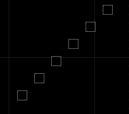

5. The function of multiple zooming and copying is shown below. To this end, you need to add a class derived from DgnElementSetTool as follows.
using System;
using System.Linq;
using System.Text;
using BIM = Bentley.Interop.MicroStationDGN;
namespace csAddins
    class MultiScaleCopyClass : DgnElementSetTool
        private MultiScaleCopyForm m_myForm;
        public MultiScaleCopyClass() : base(0, 0)
            MultiScaleCopyClass multiScaleCopyClass = new MultiScaleCopyClass();
            multiScaleCopyClass.InstallTool();
                m_myForm = new MultiScaleCopyForm();
                m_myForm.Show();
            OnRestartTool();
            return true;
            InstallNewTool();
        protected override bool NeedAcceptPoint()
            return false;
        public override StatusInt OnElementModify(Element element)
            Bentley.Interop.MicroStationDGN.Element newEl;
            double dScale = double.Parse(m_myForm.txtScale.Text);
            double uorPerMaster = dgnModel.GetModelInfo().UorPerMaster;
            DPoint3d offsetPnt = new DPoint3d(double.Parse(m_myForm.txtXOffset.Text)* uorPerMaster,
                                                   double.Parse(m_myForm.txtYOffset.Text) * uorPerMaster,
                                                   double.Parse(m_myForm.txtZOffset.Text) * uorPerMaster);
            BIM.Application app = Bentley.MstnPlatformNET.InteropServices.Utilities.ComApp;
            long eleId = element.ElementId;
            Bentley.Interop.MicroStationDGN.Element BIMEle = app.ActiveModelReference.GetElementByID(ref eleId);
            for (int i = 0; i < int.Parse(m_myForm.txtCopies.Text); i++)
                newEl = app.ActiveModelReference.CopyElement(BIMEle);
                long longid = newEl.ID;
                ElementId elementId = new ElementId(ref longid);
                Element newElement = dgnModel.FindElementById(elementId);
                DRange3d range = new DRange3d();
                ((DisplayableElement)newElement).CalcElementRange(out range);
                DTransform3d dTransform = DTransform3d.Identity;
                dTransform.Translation=new DPoint3d(-(range.Low.X + range.High.X) / 2, -(range.Low.Y + range.High.Y) / 2,
                    -(range.Low.Z + range.High.Z) / 2);
                DTransform3d dTransform2 = new DTransform3d(new DMatrix3d(dScale, 0, 0, 0, dScale, 0, 0, 0, dScale));
                dTransform2 = DTransform3d.Multiply(dTransform2, dTransform);
                dTransform.Translation = new DPoint3d((range.Low.X + range.High.X) / 2 + offsetPnt.X, (range.Low.Y + range.High.Y) / 2 + offsetPnt.Y,
                    (range.Low.Z + range.High.Z) / 2 + offsetPnt.Z);
                dTransform2 = DTransform3d.Multiply(dTransform, dTransform2);
                newElement.ApplyTransform(new TransformInfo(dTransform2));
                newElement.ReplaceInModel(newElement);
                eleId = newElement.ElementId;
            return StatusInt.Error;

7. Generate your csAddins and test. Draw a square in a two-dimensional model in advance, click the third icon in the toolbar after loading csAddins, select a corner point and drag out a dynamic label line and the specified point coordinate text, and then click a point to confirm the label position. The two generated annotations are shown in the following figure:
Click the second tool icon, set the parameters in the toolbox as shown in the figure below, select this square and confirm to generate the copy result as shown in the figure below.
In fact, MicroStation provides functions that do not require programming to customize the interface. These customized interfaces will be saved in a file called.DGNLIB, as long as the DGNLIB file is located in a directory pointed to by the configuration variable MS_DGNLIBLIST or MS_GUIDGNLIBLIST of Mstn, the DGNLIB file will be loaded when Mstn starts. This customization can be achieved by opening the DGNLIB and selecting the right-click menu Customize Ribbon on the Ribbon interface.
