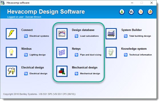

Mechanical Designer
Allows acces to Design Database, Netsys Pipe and Duct Sizing and ancialliary programs in the Mechanical design section

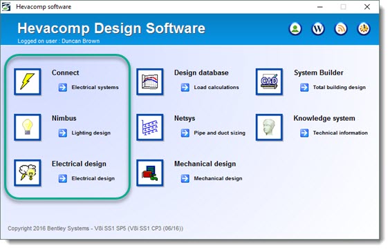

Electrical Designer
Allows access to Connect, Nimbus Lighting Design and ancilliary programs in the Electrical design section.

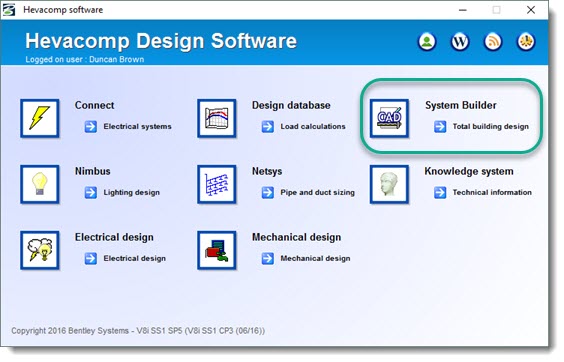

System Builder
Allows access to the System Builder program. No other licenses provides access to this program.

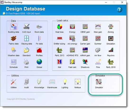

Dynamic Simulation
Allows access to the Dynamic Simulation software from within Design Database. You also require a Mechanical Designer license.

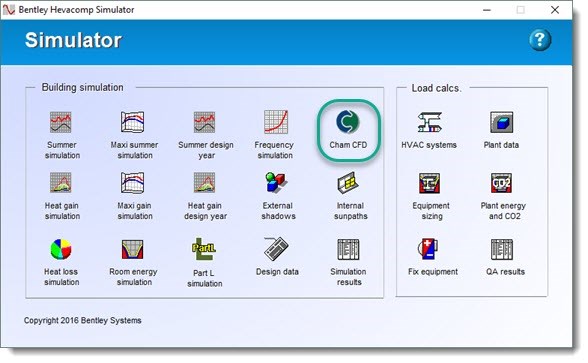

CHAM CFD
CHAM/Phoenics Computation Fluid Dynamics license, software and support is available directly from CHAM. You also require a Mechanical Designer and a Dynamic Simulation license.

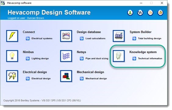

Knowledge System
All license types allow access the Knowledge System
