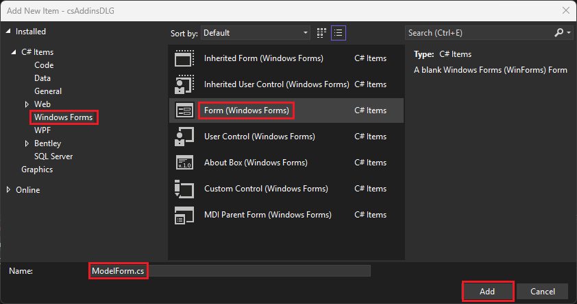

  1. Create a Form ModelForm

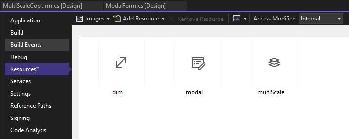

  1. Add Image Resources
To make the user interface more intuitive, add images that represent the three dialog types used in this example:
First, prepare three image files that will be used as icons or illustrations for these dialog types.
Next, add the images to your project resources:
Once added, the images become part of the application and can be accessed directly from code without needing to distribute the image files separately.
