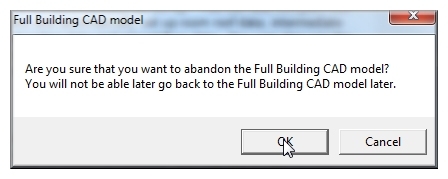

If you choose to ignore this message and turn off the "Use full building CAD model" you will be given a second chance to cancel this move:
If you select OK on this warning then your project will be taken out of "Full building cad model".
