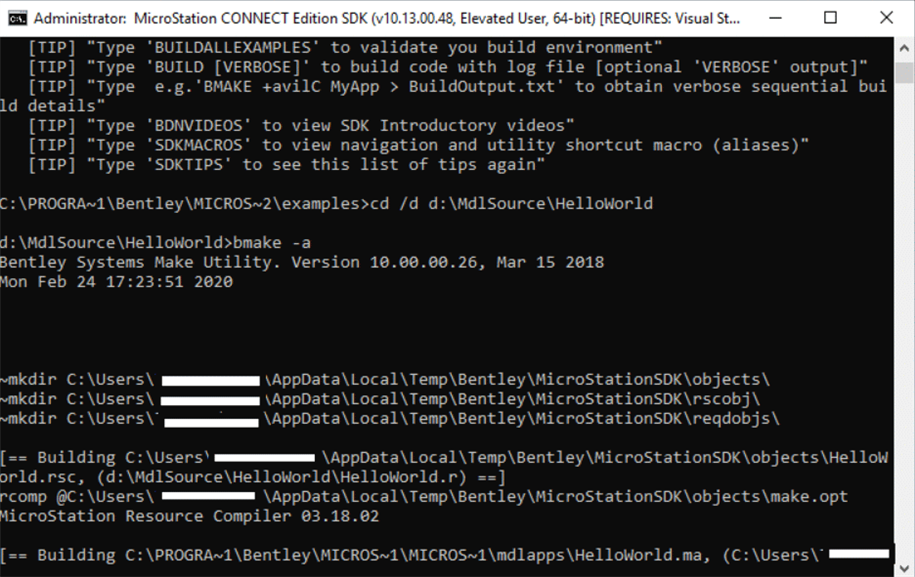

5. Right-click "Start > All Programs> Bentley > MicroStation CONNECT Edition SDK > MicroStation CONNECT Edition SDK", and select "Run as administrator" from the pop-up menu to start the MDL program development environment. After the development environment command prompt, type cd /d d:\mdlsource\helloworld and press Enter to enter the directory where our project is located, and then type bmake -a to generate HelloWorld.ma and HelloWorld.dll. These generated files are located in the …\MicroStation\mdlapps directory.
The above two commands are explained as follows:

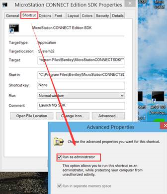

Tips: Follow the steps in the Developer Notes section of the SDK Readme to create MicroStation CONNECT Edition SDK as a shortcut to the Windows desktop, then right-click the shortcut and select properties to open the shortcut properties, and then click the Advanced button to open the advanced property settings, check Run as administrator and press the Ok button to confirm. In the future, you can simply click this shortcut on the desktop to start the development environment.

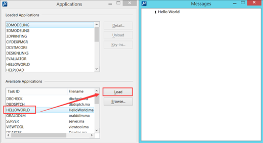

6. Start MicroStation.exe and open any DGN file. Ensure that the current workflow in the Ribbon interface is Drawing or Modeling, then select MDL Applications under the Utilities page to open the MDL dialog box, find and select HELLOWORLD in the Available Applications list box at the bottom of the dialog box. Then click the Load button to load our MDL application. A message box with the words Hello World pops up.

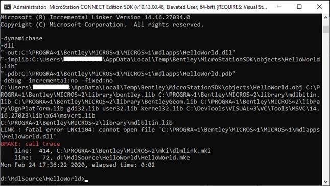

7. You need to unload the application before you rebuild any projects, otherwise you will encounter the error message shown in the figure below. The unloading method is to select HELLOWORLD in Loaded Applications at the top of the above MDL dialog box, and then click the Unload button.
Tips: You can also load and unload MDL applications by typing commands. As shown in the figure below, open the input command dialog box, enter MDL LOAD HelloWorld to load the application, and enter MDL UNLOAD HelloWorld to unload the application.
